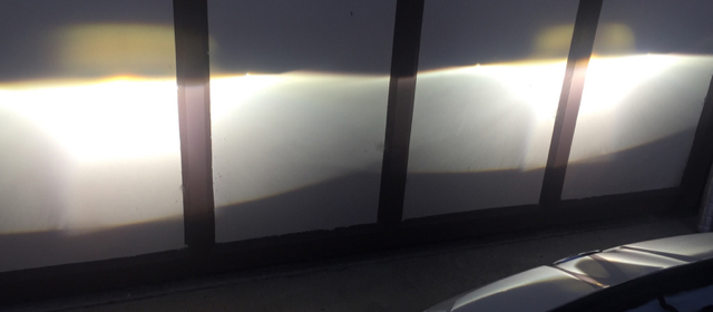

Hey guys 2016 FRS and just installed Xenon Depot Xtreme 5000k HID kit last night and getting weird yellow hue on the cutoff. I emailed the company and they told me the yellow hue is a function of the projector in our cars. Is that correct? I'll try to post a picture of what I'm talking about but having issues resizing pictures

BRO8A86 04-29-2016 10:57 AM
2 Attachment(s)
Attachment 136297Attachment 136298
Vyconis 04-29-2016 12:54 PM
That's the cutoff that you need to bend inside the projector housing. Pretty much the stock projectors were designed to project halogen bulbs. HIDs have different light dispersal patterns. I bent the plate inside down and got rid of basically most of that.
Vyconis 04-29-2016 12:56 PM
Almost all the people who stuck with stock projectors and did HID kits do that. I researched a lot about it from the forum and other sources and that's what was recommended.

BRO8A86 04-30-2016 03:20 PM
Are the FRS stock projector lenses not clear?
Originally Posted by NyC Zn6 (Post 2637961)
Also a 10 Series/Monogram/RS 1.0/RS 2.0 :iono: ....or he can just bend the squirrel finders :popcorn:
Thanks just looked up "squirrel finders" and found what I needed
