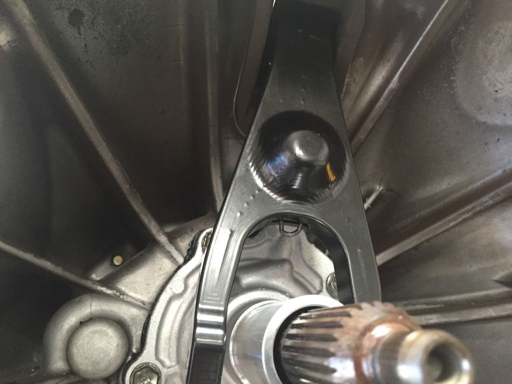

mhiscott 07-21-2016 08:20 AM
I think the idea of the stock fork not being able to distribute load evenly could be what is happening.
As I said in my earlier post, I have an FX400, which is a fairly heavy clutch. Since installing the clutch I’ve had engagement issues. Feels like a slight clutch drag when clutched in. I adjusted the master cylinder to no avail, dropped the transmission a couple of times to relubricate the TOB, and replaced the TOB more than once in an effort to fix the annoying issue.
I actually had the TOB clips break on me before as well. I made a thread about it at the time.
http://www.ft86club.com/forums/showthread.php?t=74366
Here’s a video from back then showing what happened to my TOB clips.
[ame="http://www.youtube.com/watch?v=AZiilzaDVWs"]Frs clutch tob - YouTube[/ame]
I have since installed a Velox fork with a new TOB.
http://i66.tinypic.com/312jqww.jpg
I noticed when it was apart, that the surface the TOB rides on was pretty marr’d up. See two pics below.
Has anyone seen this before on an FRS with a heavy clutch and factory release fork? My theory is the fork was distorting, and the bearing was being actuated back and forth on a non-perpendicular angle with the input shaft snout causing these marks. You can actually see two cupped wear marks towards the front of the snout. It doesn't look like a happy camper.
http://i65.tinypic.com/kbdgys.jpg
http://i64.tinypic.com/2hq8dnd.jpg
From what I can gather from the diagrams online, this is the part scored up on mine:
RETAINER-BEARING
Part Number: 30099AA040
I’ll have to order a new one, and replace it when I get in there to do the Velox pivot ball.
