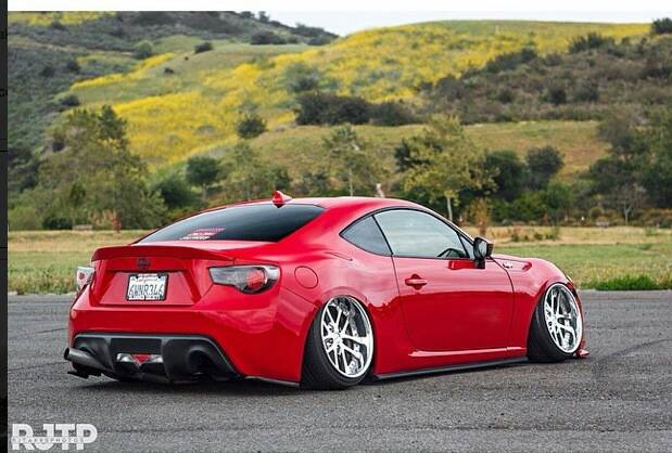

lizbrayan 04-23-2016 03:14 AM
Attachment 135919
Like the set up of this car is great. I invision my car to look similar to that just a little less front camber.
Sent from my SGH-T999N using Tapatalk

Originally Posted by softgrip (Post 2631452)
https://encrypted-tbn0.gstatic.com/i...f-5ajZjRo4QWBk
You really want to look like a baby giraffe?
The giraffe only has front camber, i need back too so i cant look like him lol

_gt86_user 04-23-2016 12:38 PM
Just slam the shit out of it, obviously you like the look of Nabeels red twin so just go super low with as much camber as you can fit, buy wheels that look like they don't fit without tires then stretch the smallest tire for the rim you can find, honestly not that hard to lower it all the way down and get wheels that rub and that you have too MAKE fit.
It seems like you have no idea about any aftermarket parts, so it looks like you just want someone to straight out plan your build for you with prices and specs and tire sizes camber specs and all that, honestly it's ALL personal preference just go as low as YOU handle and remember if it's drive able it's probably not low enough. Just lowering your car on coilovers and buying XXR wheels that don't fit is not stance.
