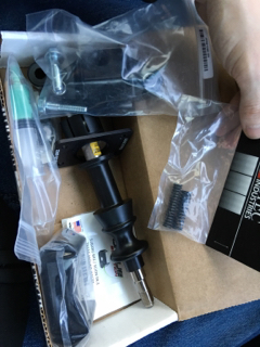

Beechnut87 04-09-2016 10:28 PM
3 Attachment(s)
Attachment 135149Attachment 135150Attachment 135151 Some goodies from the mail, thank you FT86Speedfactory for getting this out quick style it really helped.

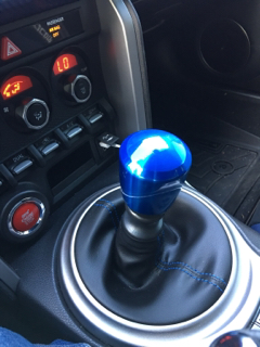

Beechnut87 04-10-2016 05:45 AM
So my first impression of the shift knob being 735 grams (1.6lbs) is that its COMPLETELY changed the ride. It is significantly heavier, like way heavier, and it just lets you throw it threw the gears effortlessly. There was not much effort to it before but not it just chunks right threw gears, i love it and am almost scared to put the short shifter in because it may be too much but well find out Wednesday when i have my free time to do the install.
