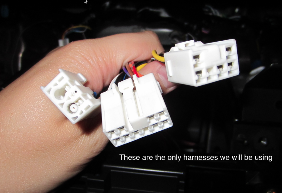

When I test drove my car I saw there was some extra wire harnesses in the glove box and I told my friend (who was the salesman) that I wanted all of it with the car. Although, I have no idea what any of it is for except one looks like an antenna adapter of some sort. Anyone have any ideas?

Here's some pics of the mystery wires, the one on the far left has the same style plug as what I plugged in, the third pic is a close up of the opposite side of it...
http://img262.imageshack.us/img262/9588/27792216.jpg http://img7.imageshack.us/img7/4268/49530674.jpg
http://img513.imageshack.us/img513/5857/19995588.jpg
http://imageshack.us/a/img201/9588/27792216.th.jpg http://img7.imageshack.us/img7/4268/49530674.th.jpg
(click thumbnails to see larger versions)
Thanks! I was close. The harnesses are used to install your radio into a different car.
Looking at the harnesses in the first picture...
The first adapter harness (left) converts to a different style of OEM USB connector.
The one with the 28-pin plug fits your radio's socket (for aux, mic, and a few other signals), and converts that to Toyota 20-pin and 8-pin sockets.
The last one converts one of the radio's power/speaker sockets (the 10-pin one) and your radio's antenna socket to the same 10-pin connector (with the power antenna control there instead of on the antenna socket), and to a different style of OEM antenna connector (looks like a normal Motorola female).
SVXdc 07-01-2012 10:47 PM
If you can post close-up pictures looking at the top and bottom of the adapter with the 28-pin plug, I should be able to map out what pins the radio uses and where they connect on the 8- and 20-pin sockets.
Also, see my earlier post -- I added a PDF from the FCC's site that shows pictures of every side of the radio (including the rear with nothing plugged in :)).

SVXdc 07-03-2012 12:43 AM
Originally Posted by Thongpocket (Post 291319)
The one on the right is def sat radio harness.
No, it's definitely not. It's a reverse antenna adapter that fits the radio's AM/FM antenna socket. Converts to a Motorola socket (I've confirmed that from other pics I found).
That portion is identical to a Scosche reverse antenna adapter (minus the extra branch with the black rectangular plug):

On the adapter Robbie found, the portion with the 10-pin power/speaker plug/socket simply passes all but one of the wires straight through (pin 1 to 1, 2 to 2, etc.), and it changes how the power antenna control lead is wired.
