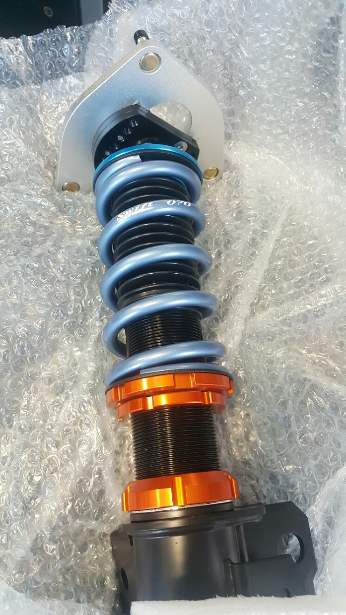

Here is what it looks like new:
Attachment 133765

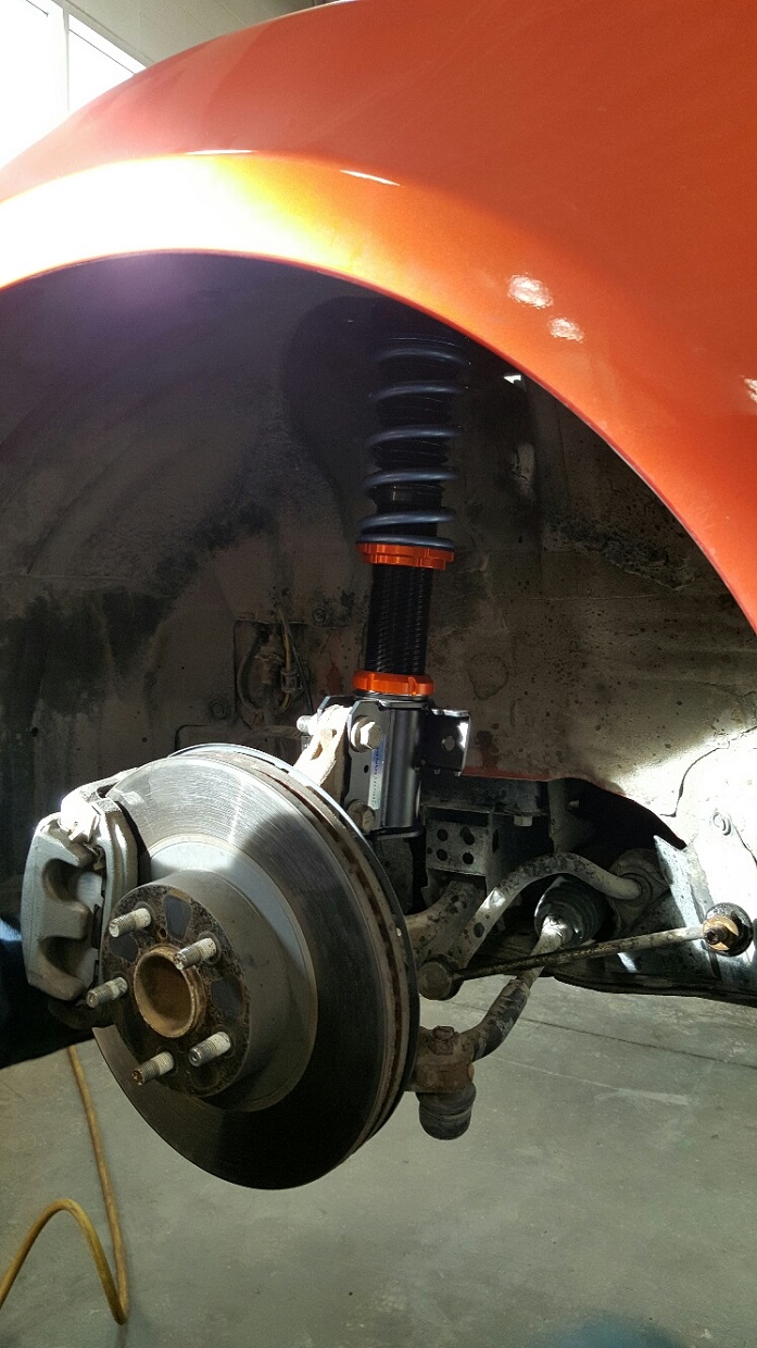

installed on the front (stock height)
Attachment 133766

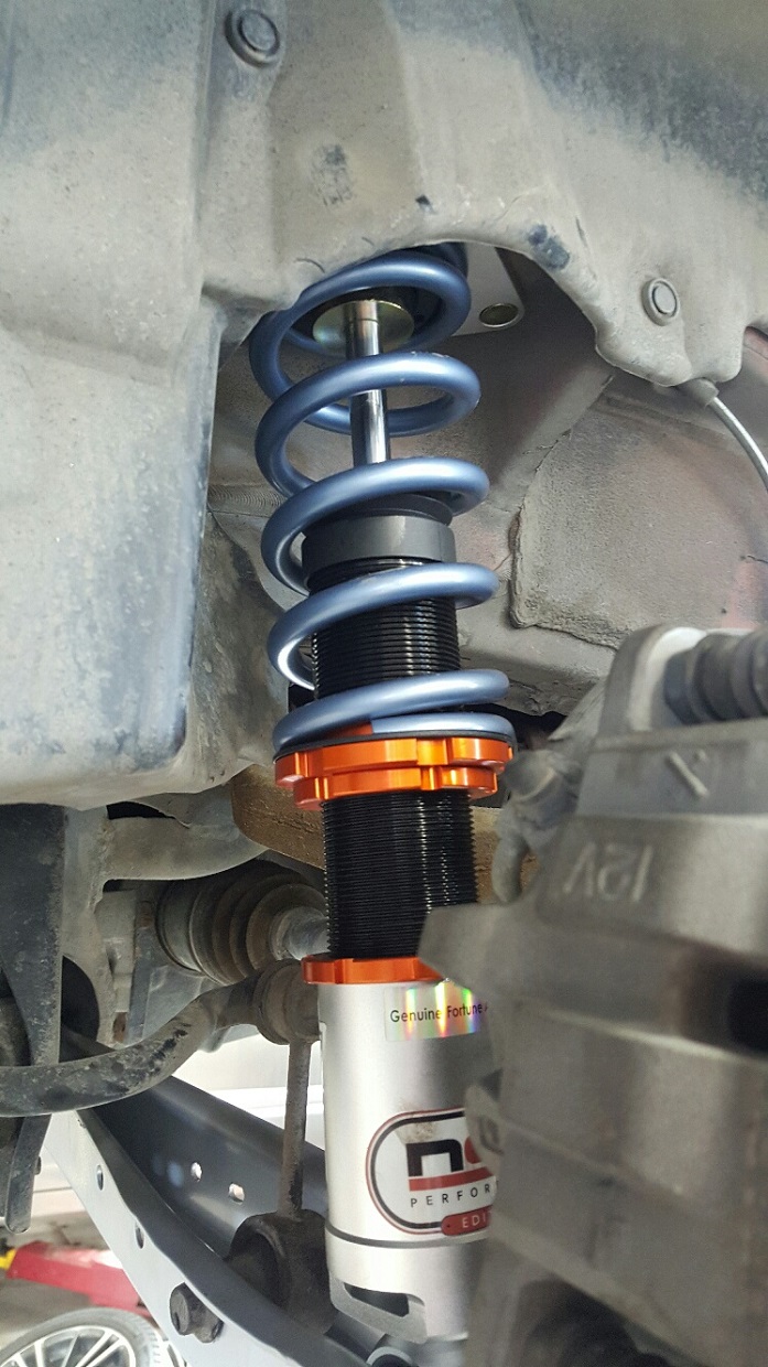

installed on the rear (stock height)
Attachment 133767
