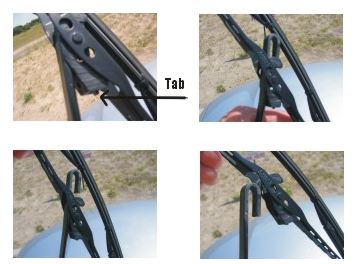

go_a_way1 03-11-2016 08:16 AM
2 Attachment(s)
Originally Posted by notout86 (Post 2576990)
Thanks go_a_way1, but from what I see on the youtubes of hook types they still angle the blade at roughly right angles to the arm before they fiddle with a latch bit and get it off the hook.
I cannot get the blade at anywhere near right angled without using force and it feels as if I might do damage. Where is the latch anyway?
I just KNOW I am going to feel stupid when I get to the bottom of this.
Here are some picks. Some styles have the tab like the first photo and the others have the latch on the top. Sometimes they can be a bit of a bitch to get off. You only need to turn it 90 degrees once it's of the hook part to slide the hook part down through the center of the blade
Attachment 132910
Attachment 132911

OK I know how to do it now and worked it out myself (actually before I saw go_a_way's excellent post # 5 for which I commend him and he's earned a Special Thanks). It turns out that NONE of the youtubes illustrate our blades which are unusual, and therefore I do not feel stupid and all you know-it-alls can get back in your boxes and I hope you damage your wipers. So there! :paddle:
For other people with open minds the trick is to not attempt to get the wiper perpendicular to the arm but simply lift a latch on the back of the hinge (fingernail or padded screwdriver) and then you can slide the blade and get it off the hook. You could lift the latch with the wiper on the glass to start with.
