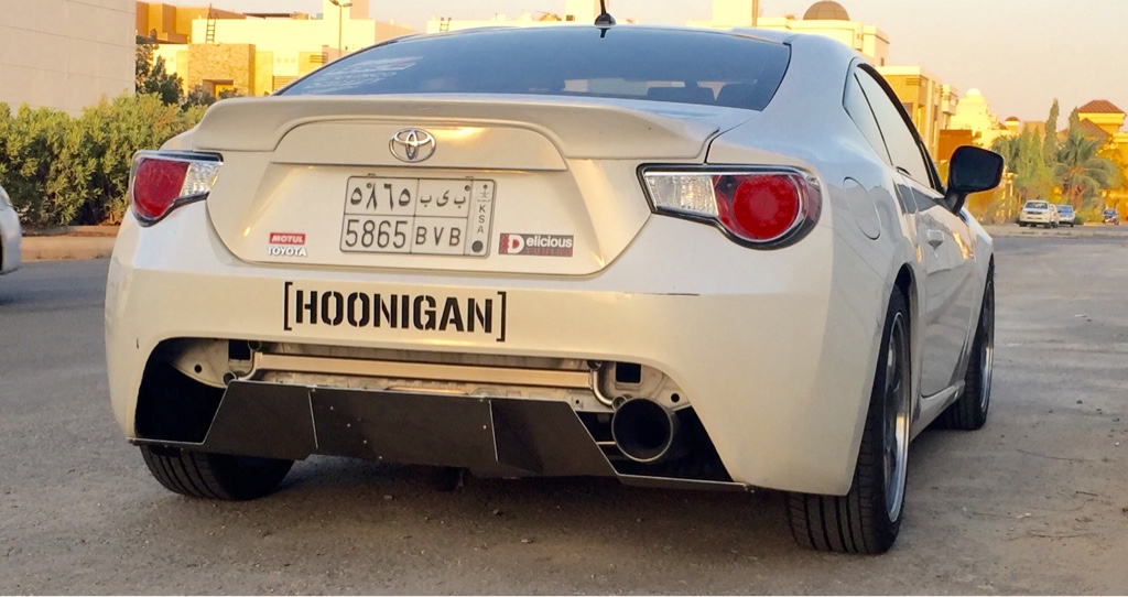

8686 02-11-2016 02:57 AM
Attachment 131074
Sent from my 86 using Tapatalk
