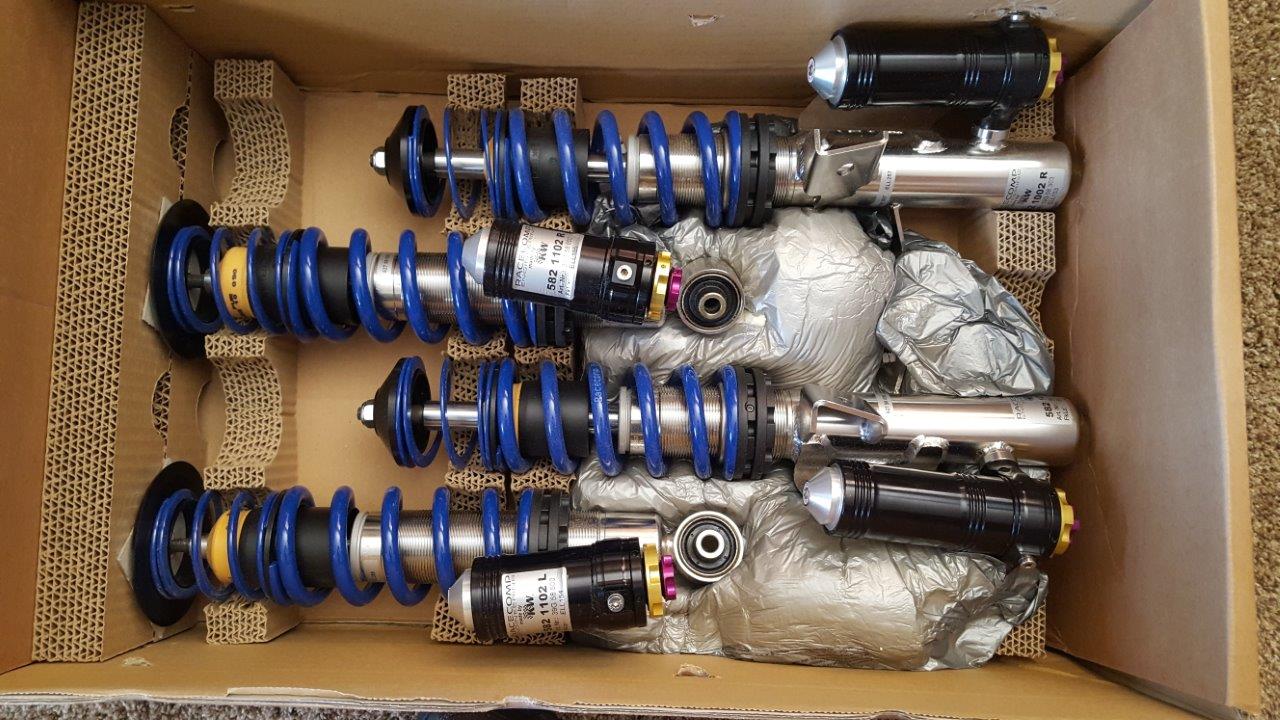

Wonder no more....
Racecomp T3 Clubsports. They look like jewelry. I almost don't want to install them. Ahh, who am I kidding... they're going in this weekend!

Definitely going stiffer. The car doesn't get driven much on the road anymore so the ride quality can suffer a bit. I have an event this weekend at the set up is 450# Front, 550# rear. But I think they will end up being a bit stiffer than that once winter testing is complete.
On the flip side, the bars are going softer. Using the Whiteline front bar at full soft and the rear bar is currently the stock bar.

The T2's were great. I had no issues with them whatsoever.
Also, I'm working with Racecomp this season and Myles highly recommended them. I knew I wanted to use higher spring rates this year so upgrading made sense. The T2's can handle more spring rate than I was using, but I the T3's capabilities were even greater, and I wanted the additional flexibility of the dual compression adjustment.

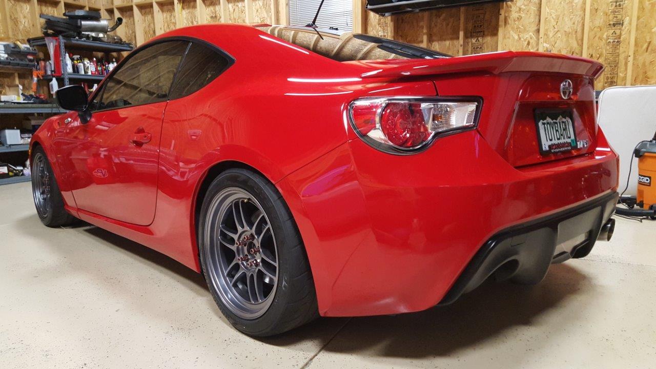

Silverspeed 02-15-2016 08:46 PM
2 Attachment(s)
Some pics of the ride heights set, more or less where they need to be. I haven't had the car on the scales so this will change but for now 25" to center of rear fender and 24 3/4" to center of fronts. Rear springs are new so they will come down on their own a bit.
Attachment 131320
Attachment 131321
