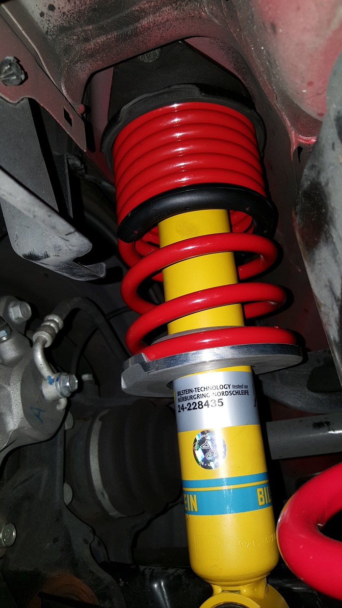

Does anyone have pictures of the rear trd lowering springs installed? the top portion of the spring is all compressed and the coils touch while at rest. this is my setup, the trd springs are sitting on billstein b8 shocks so idk if that matters. but are they supposed to be touching like that?? thoughts?Attachment 130814

This is normal.
Very common for a lot of lowering springs that are progressive (most are)
Mw

Thank you very much for the quick response I was worried because I didn't know they were supposed to touch at rest I thought the gap was supposed to be minimal but not touching but you help me to not stress anymore thanks again
