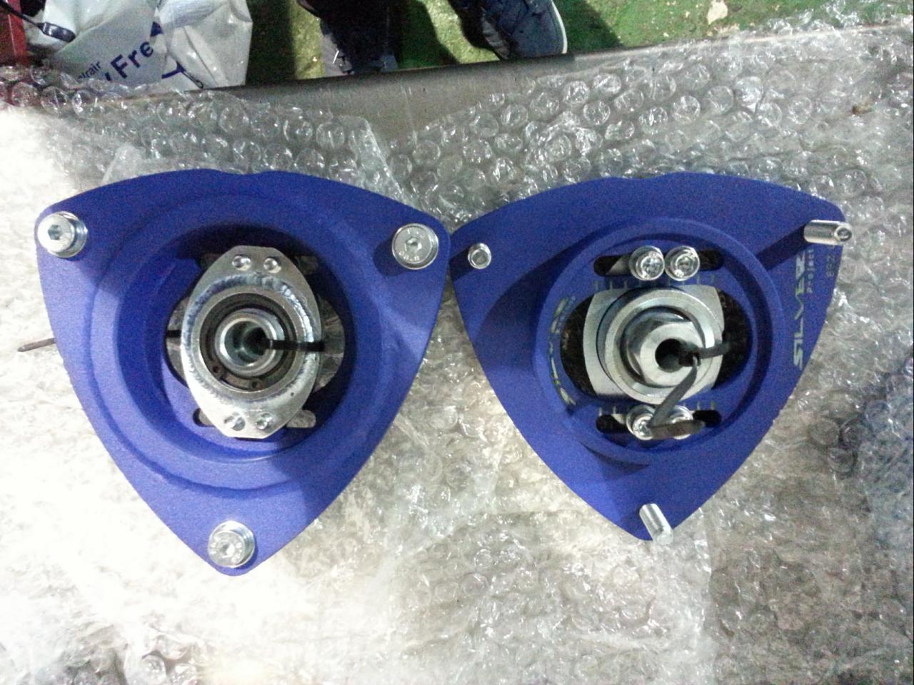

makinen 02-08-2016 07:46 AM
2 Attachment(s)
I've used it about an year with Koni's and RCE Tarmac springs.
Basically no height rise, but for the balance of my suspension setting, I've added rear 1/4" rear spacers from Subtle solution.
Attachment 130830
Attachment 130831

That sound usually indicates loosened top nut.
