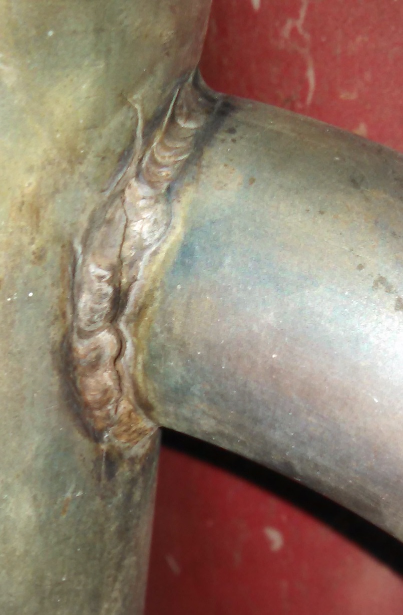

This morning I started hearing a nasty metal on metal rattle. I was worried. After I got home from work I spent over an hour trying to figure out where the sound was coming from. With the help of my beautiful roommate assistant, and a mechanic's stethoscope, a was able to determine it was coming from the post header exhaust somewhere. I jacked up the car and saw the following:
Attachment 129101
Attachment 129102
As you can see the weld that held the resonator to the high flow cat failed and was rattling pretty loudly. The weld for the pipe of the resonator was also cracked a little.

e1_griego 01-14-2016 12:28 AM
Where's the break? And was the noise constant?

stockysnail 01-14-2016 01:18 AM
Break was where the resonator was welded to the high flow cat. The noise wasn't constant but more dependent on the vibrations of the engine at different RPMs. I bent it out a little so hopefully it doesn't vibrate, but now I have a little hole in my cat where the weld was.
Akari 01-14-2016 06:27 PM
Honestly looking at the crack I'd just have it welded if I were you. Much easier and cheaper than taking it off, shipping it back and then having to install a new one.
