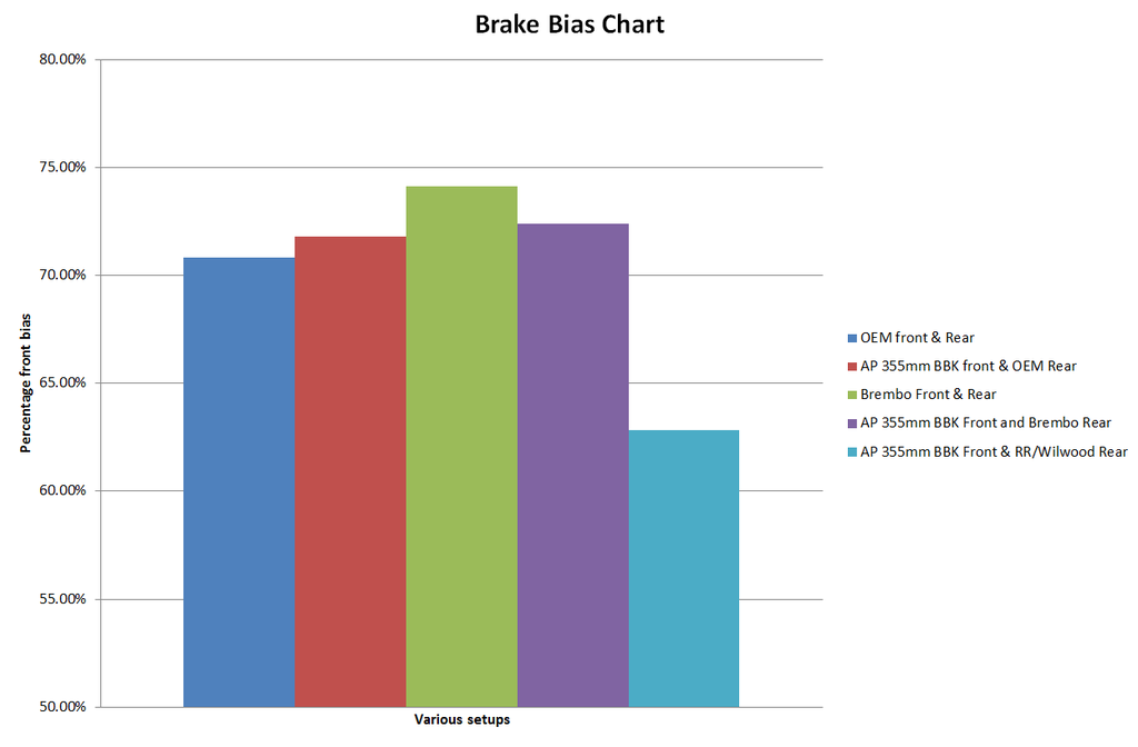

"obviously there was a little bit more front bias as one would expect with a front only kit" - Do you have any numbers and/or test data to indicate that the Essex kit has a front brake bias?
There's no comparison on the technical details, like brake bias (of both kits), rotor sizing, piston area, heat dissipation, or actual on-track performance. Is this really a comparison?

As for a 'comparison' thread, I agree that there's not a whole lot of viable comparo data here yet. That's okay though, and I do look forward to seeing some hard numbers. I would expect to see some differences, because our Essex Competition Kits and the RR Racing kits are very different products. Our kits have a singular objective, to go faster for longer. They are specifically designed to be extraordinarily lightweight, durable, and fade-resistant for optimal track performance. They address the FT86's brake deficiencies in the most simplistic manner, and provide the greatest improvements in the area where they are needed most (the front of the car). All other considerations are secondary. They aren't the prettiest, and definitely not the cheapest, but they are brutally effective.
Back to the bias comment from the OP...It is important to note that our kits bolt on without any other modifications and are intentionally designed to have minimal impact on the factory brake bias. As such, they integrate seamlessly, and have proven to be a winning solution in sprint racing, endurance racing, rallying, hill climb, time trial, HPDE, and autoX all over the world...all while running the OEM rear brakes.
*Update 4/19/16*
We finally had the chance to run the calculations for the front RR Racing/Wilwood BBK's. The figures below are the % of front brake with the rear OEM brakes left alone. Our Essex Sprint Kit actually has less front brake than stock, shifting a little bias rearward (the exact opposite of what was claimed in this post). Our Endurance Kit has a little more front bias than stock, but still less than all of the RR Racing kits. The RR Sport Performance Kit would probably be a bit too front biased for most of our customers. Heat would be increased in the front brakes, and the fronts would likely lock up while the rears were still rolling.
We haven't had a chance to do the calculations on their rear kits yet, but hopefully soon. As you can see though, any talk of our Essex/AP kits being more front biased are untrue. The opposite is in fact true. Thanks.
% of front brake:
Stock 67.1
Essex Sprint 66.3
Essex Endurance 68.5
RR Sport Performance 72.9
RR Stage 1 69.4
RR Stage 2 69.4
RR Stage 3 69.6
RR Stage 4 69.6
If you go back through our threads, you'll see that we looked closely at creating a rear competition brake kit for this car about three years ago. We determined that the value of such a kit was minimal for our typical customer given the capability of the OEM rear brakes. We'd much rather see our customers sink their money into the front, where the demands are greatest (most people tracking these cars will go through 3 sets of front pads and discs before needing replacements for the rear).
All of that said, we don't inherently have anything against rear brake kits. We sell competition rear brake kits for other platforms such as the Corvette, various M3's, etc...even using the same CP8350 caliper body (see pic below). Some platforms benefit from them far more than others. The FT86 just isn't one of them.
http://www.essexparts.com/imagecache...Large/pat3.jpg
We also sell the AP Racing Factory rear BBK's for the FT86. If you want to look cool, nothing beats a huge four-wheel brake kit. You won't get any argument from us there. There's certainly nothing poseur about these kits either. They are serious hardware. For some customers they are the ultimate solution. For serious track enthusiasts however, we tend to steer them away from those kits. They just don't offer as much bang-for-the-buck.
http://s8.postimg.org/96w2avtxx/PX7_A6928_1a.jpg

As mentioned by @DAEMANO, I don't agree that RR Racing choosing not to respond with simple specifications indicates that they have something to hide. I can't find any publicly released piston sizing information for the APs kits with a quick forum or Google search either although I'm sure you'd be happy to release that info to anyone who asks for it. For the sake of disseminating information, I will comment on the RR Racing sport performance (4 pot) front BBK because I bought one.
When I first got the kit (a few weeks ago now) I measured the pistons and recall they were ~38mm based on my eye and a crappy school book ruler. The rest of the relevant info is available on their website so I stuck the values in a torque calculator and came out with a slightly higher torque value with the RR Racing front kit than stock. I did this a while ago so I don't remember the exact values but my point was that Rafi mentioned this was the case so I can confirm he never said anything misleading or incorrect.
I realize it seems the real issue CSG and JRitt have is the claim that increasing rear bias is beneficial when their own findings indicated that wasn't the case and are looking for data from RR Racing to back their claim up. I'm not going to lie here, I DO think the rear kits are primarily superficial especially for cars with no rear downforce so I have no plans on getting one.
In the end, I'm of the opinion that AP's caliper and rotors are the best so if you want the best, you need to pay the extra to go with AP. In my case, I'd love to get an AP kit but the reality is that I cannot pay for it now or in the forseeable future. If an affordable alternative never appeared, I'd never be able to upgrade. Suggesting that I save up for it isn't helpful because I'm also saving for a house and every dollar spent on something else is a dollar that doesn't go into the house. This is why I look for products that are 70% of the high end product for 50% of the cost and RR Racing has released an offering that appears to be in this range, targeting people like me.

ajc209 01-18-2016 11:07 AM
Not sure why there is a problem with RR racing not publishing data on brake bias. Theres a gragh on page 11 of their thread where they were showing the ratio front to back.
The calipers are all standard wilwood calipers. Took me all of about 5 minutes to look up piston sizes on their website.
Its the rear brakes that move the bias back ~8-10%. The RR racing fronts have a piston area of 52cm^2 which is very similar to the CP8350 (~50cm^2 IIRC)
I agree that this "comparason" is not really very in-depth or technical. My suspion is that you'd be hard pressed to tell much difference between the $1600 RR and $2100 AP kit front kits.
Obviously at some point one will fail for whatever reason, but for the average weekend track junkies they will both do a good job.
JRitt 02-02-2016 12:51 PM
That graph is essentially meaningless. It shows relative bias within the product line. That chart only allows comparison among the RR Racing kits. There are no absolute values to use for the calculations vs. OEM or anything else. Using that chart to compare bias to anything else is essentially the same thing as comparing an engine dyno plot from one type of machine to another (Dynojet vs. Mustang). It's basically meaningless.
Yes, but disc diameter also comes into play. They use 328 and 330mm discs on the front, which also adds more front brake torque on the front axle (in addition to larger piston bores).
I dug the numbers up on Wilwood's site and we're going to run them and see what we're looking at in terms of how they impact bias. That should give an actual scientific look, with real numbers, at how their kits compare to ours (which I believe was the original purpose of this thread).
Does anybody know what the piston bores are on RR's two rear kits? Wilwood has three piston options on the Wilwood Powerlite, and two piston options on the rear Superlite. I'd rather not have to run all possible simulations if we don't have to do so. Thanks.
ajc209 02-02-2016 01:04 PM
Hardly meaningless, it shows the RR front / OE rear combo as ~ 2.6:1 which is ~72% front. Stock car is about 71%.
The powerlite used in the sport performance are 1.25" IIRC and its a ~316mm brembo STI disc.
Here's my graph - I have a 355mm AP kit from an imprezza so that why I have that included in the numbers but you can see the effect the various rear brakes have in comparason.
http://i12.photobucket.com/albums/a2...psvkssxcyc.png
JRitt 02-02-2016 03:02 PM
Hmmm...I swore when I looked at it, it didn't have a scale. Regardless, I'm going to run the numbers anyway and see what we come up with. The OP's comments about our kit being "too front biased" in particular was very odd to me. My memory was that we were very, very close to stock bias. Thanks for the tip on the rear piston bores!
ajc209 02-02-2016 03:16 PM
I ran the numbers on your kit a while back and they were both within a percent of stock. Sprint slightly less, endurance slightly more. I missed the comment about too much front bias otherwise i'd have spoken up.
MaximeT 02-02-2016 03:37 PM
By "too much", I think what was meant was "same as stock".
ajc209 02-02-2016 04:43 PM
Well FWIW I tried a slightly higher friction pad in the back of my car to try it out and I didn't notice any ill effects. I think you probably need to do the pedal dance to really notice it (which I didn't).

JRitt 04-19-2016 09:43 AM
Originally Posted by Gear_One_Performance (Post 2532808)
Pretty much, but again these weren't track conditions or anything super scientific. That was just our initial feel after having them on the car for a few weeks, once we get some warm weather and clear roads we'll throw the datalogger in the car and take it back out.
% of front brake:
Stock 67.1
Essex Sprint 66.3
RR Stage 1 69.4
RR Stage 2 69.4
RR Stage 3 69.6
RR Stage 4 69.6
