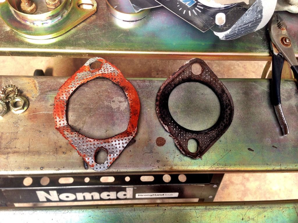

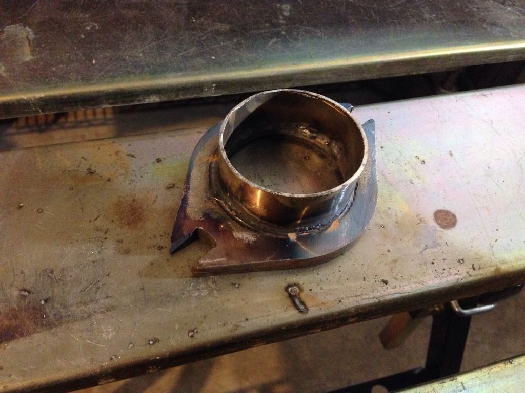

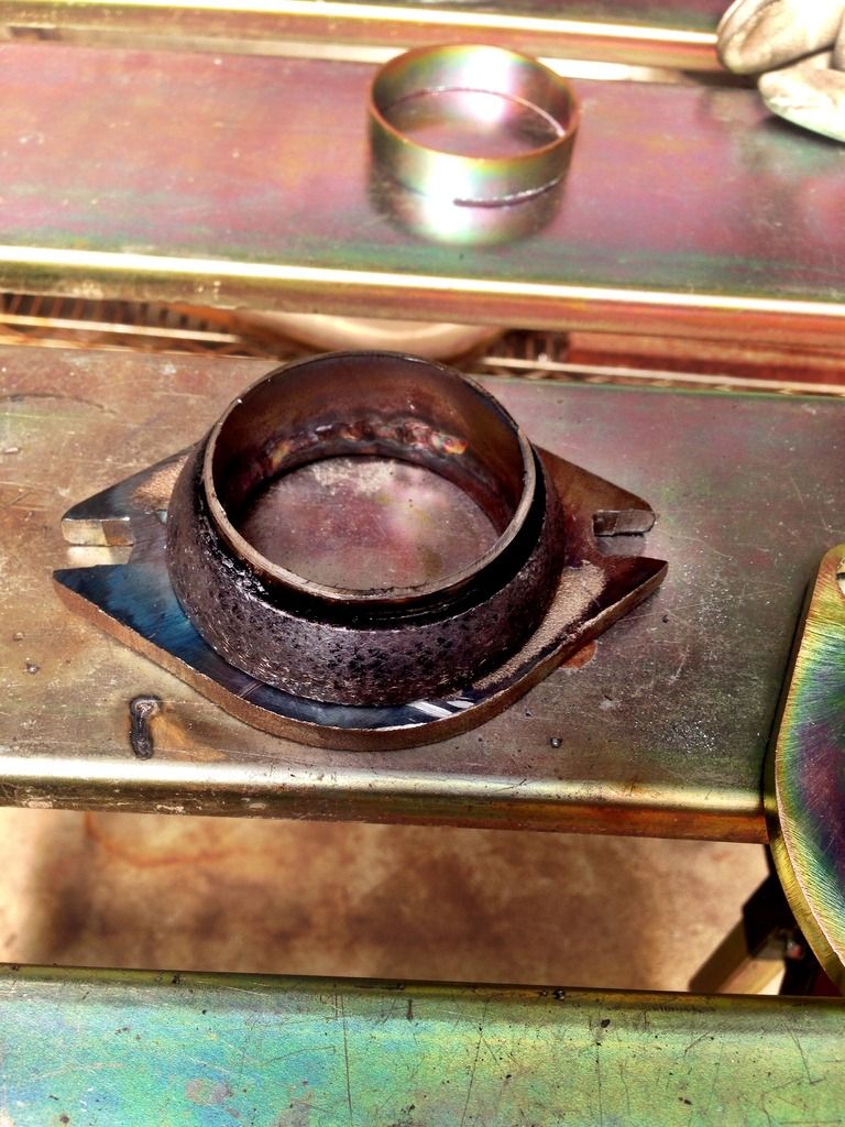

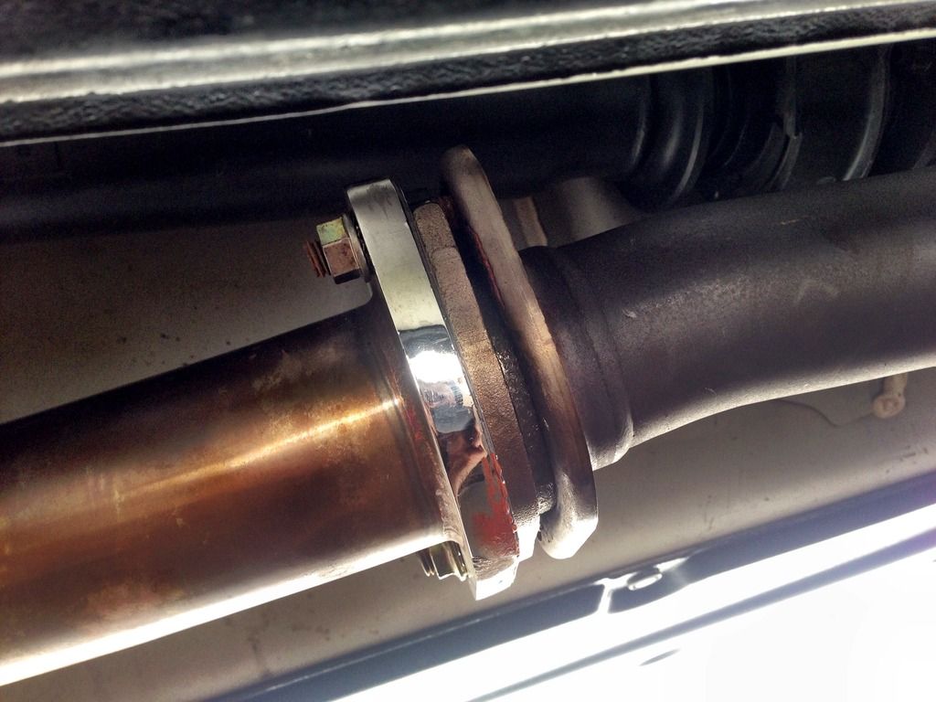

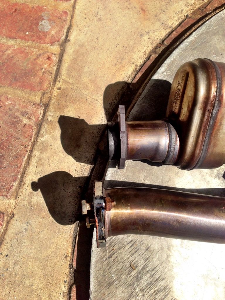

I fabbed an FP doughnut gasket adapter for this J2 pipe from a scrapped exhaust:
http://i174.photobucket.com/albums/w...FF6B4A5F73.jpg
Little to long: but will not interfere with fitment:
http://i174.photobucket.com/albums/w...7D1A310D05.jpg
I didnt realize how much longer the J2 pipe was:
http://i174.photobucket.com/albums/w...D1D44D8ECF.jpg
At least a good 1.5" longer from eyeballing, 2" with the adapter added:
http://i174.photobucket.com/albums/w...91DF2E85AE.jpg
The old crusty:
http://i174.photobucket.com/albums/w...BBF0FFBE60.jpg
New gaskets:
http://i174.photobucket.com/albums/w...EBB7345EE8.jpg
Installed and checked for leaks:
http://i174.photobucket.com/albums/w...6213B2E0E2.jpg
FP with new gaskets and adapter fist log: http://datazap.me/u/solidone/stg1-fp...mark=6730-6703
Horrendous "knock," topped out at -5 flkc... All that work for even more "knock"
If I torque down the hardware any more stuff is going to start getting twisted and bolts will stretch or break...
