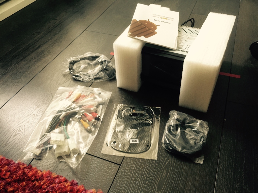

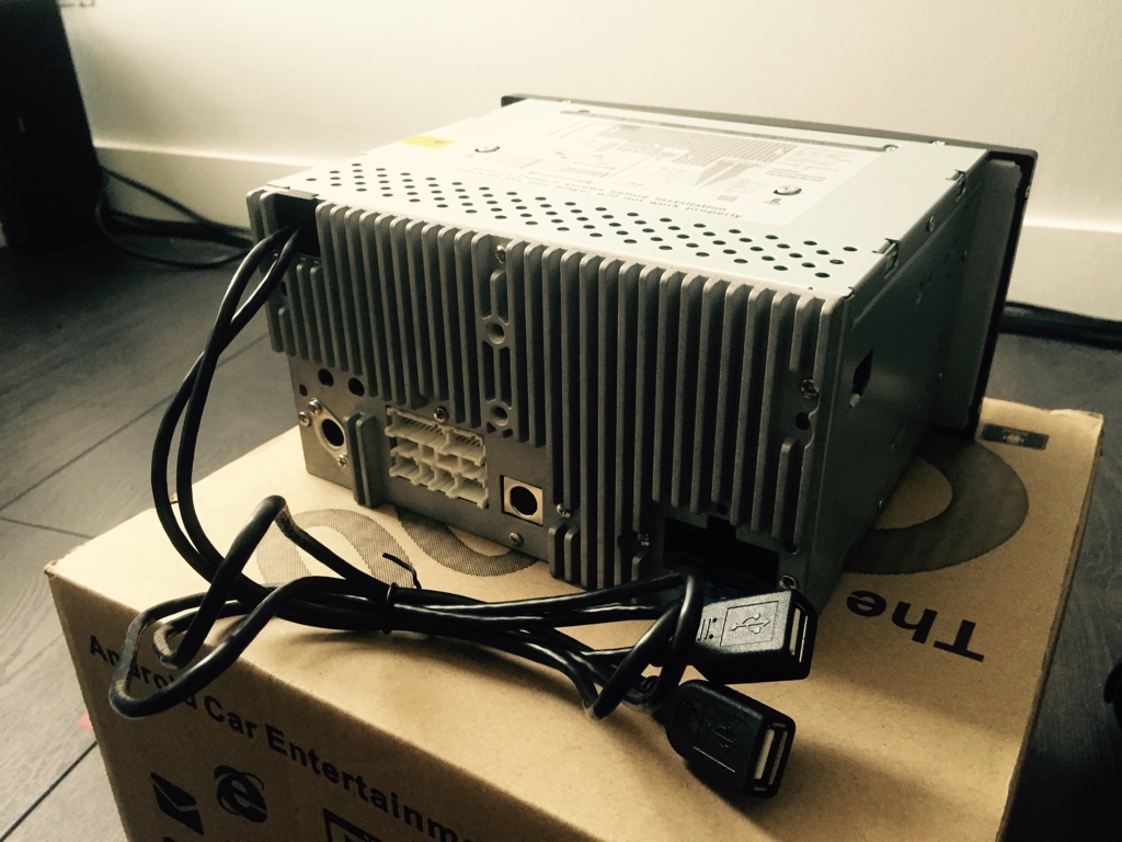

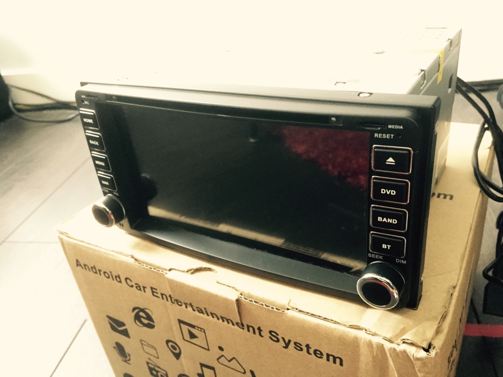

Parappa 07-09-2015 01:57 AM
5 Attachment(s)
I ordered the unit from the Ownice store on eBay, overall it was a pleasant experience, any question I had they answered quickly. Also making sure that they had the Canadian maps for the GPS. The HU came double boxed which was pretty nice and a really funny thank you note.Attachment 114584Attachment 114585Attachment 114586Attachment 114587Attachment 114588
