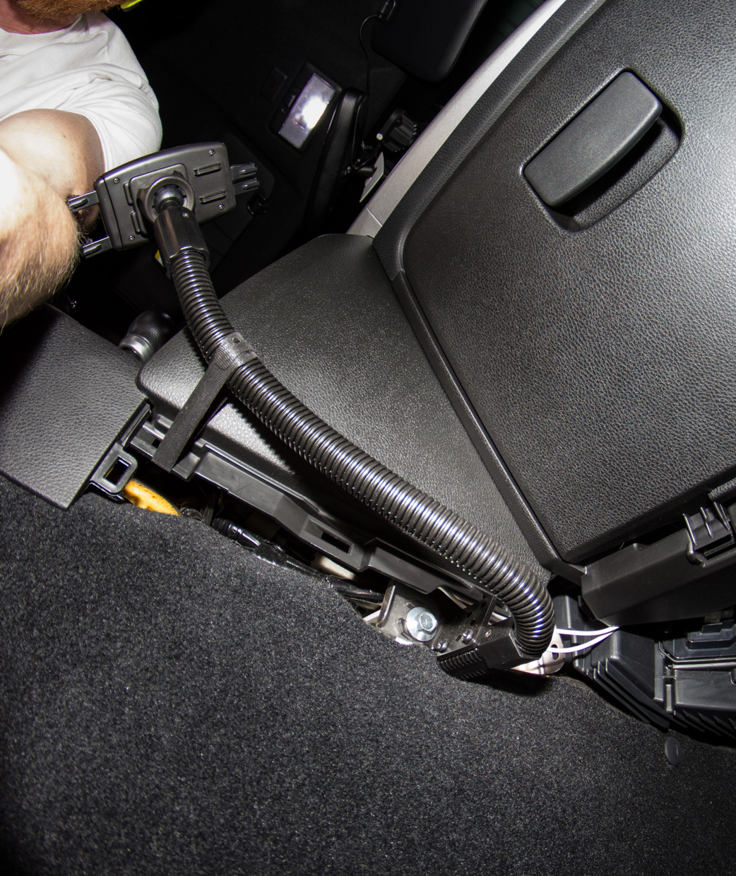

Arkon arm mount. It's a foot of bendable metal pipe covered in flexitube, with an adjustable spring clip phone holder on a ball pivot.
I bolted it to the right side of the center console in the passenger footwell. Pop off the removable panel covering the mount point. You could dremel the panel to fit it back but I just left it off. because :burnrubber:
The missing panel also leaves a good spot to strap down the arm with some velcro to minimize road vibration. The phone sits right next to the shifter.
Bonus points: Replace the OEM USB port and its single low amperage port with a pair of USB/Lightning cables snaked behind the dash to the globebox dashhole and a dual output USB adapter. Cables tuck into that pocket in front of the shifter.
I'll take some pics later.
P.S. If anyone says you can bolt the Arkon to the passenger seat rail instead of center console, they're a damn dirty liar. I saw that recommendation and proceeded to spend the better part of an afternoon trying to make it work. The seat mount has a massive dimple and there's no way to get the Arkon's mount plate in there securely.
Attachment 104787
Attachment 104788

Mine fits a Nexus7 if you swap in smaller clips on one side.
