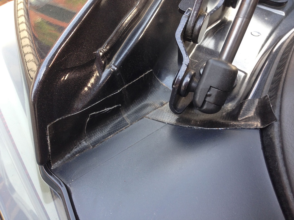

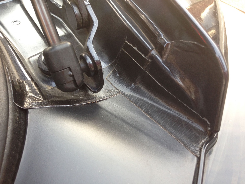

For anyone with a FRS/BRZ/GT86 (stock or aftermarket tail lights/gaskets), you should definitely cover the gaps between the trunk and the tail light housings. Lots of people have recommended silicone or "snot", but those methods make a mess or are unsightly. I just use waterproof black 'Gorilla Tape'. It's cheap, affective, and easily removable/replaceable.
Attachment 103859
Attachment 103860

wdninja 06-02-2015 09:52 PM
Just to reiterate, I'd really recommend using tape over the gap between the trunk channel and the tail light housings. Especially if you have to remove your tail lights for any reason in the future (swapping them out, changing for aftermarket, or another repair), it'll make it way more difficult using caulk.
All the adhesive you should need is sealing the gasket to the tail light housing.
