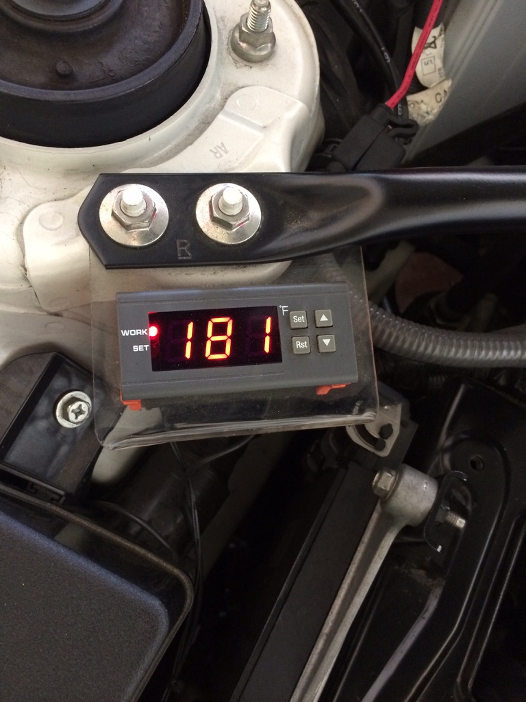

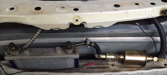

AJPG 02-27-2015 06:32 AM
3 Attachment(s)
The difference between V3 and V2 have been discuss before in this forum...
It keeps the SAME compressor (impeller and housing) change the gear side to be more robust, but at the same F... time start to use the contaminated and hooter engine oil... Can you believe that??!!
As oil the monolec, used on the vortech unit is the best we could get and is what I use in my setup. I DONT recommend the use of the engine oil due to normal engine wear and higher temps.
The SC oil cooler with inline filter and oil pump
Attachment 103427
The SC oil pump controller with the max temp ever recorded
Attachment 103428
Off topic, speed with the 4.88 final drive
Attachment 103429
Photos of the oil lines in and out the SC as soon as I take them.

Tye300 02-27-2015 11:13 AM
@AJPG, could you show pics of the supercharger unit? I want to see how you tapped the oil lines on it. Thanks!
AJPG 02-27-2015 11:20 AM
Sure [ATTACH]103451
Guess witch is in :)
AJPG 02-27-2015 11:21 AM
Please don't drill the valve cover!
Lol
Tye300 02-27-2015 11:23 AM
Thanks! Hmm, looks like the drain line is being used as in, looking at the pump assembly. Is that right?
