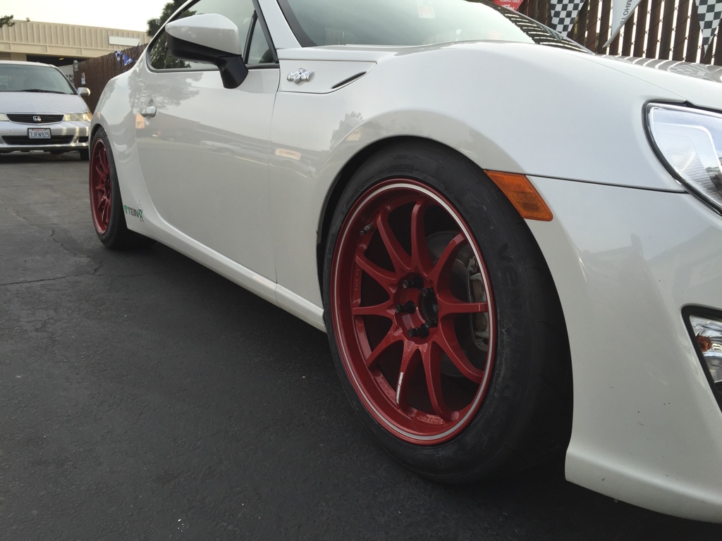

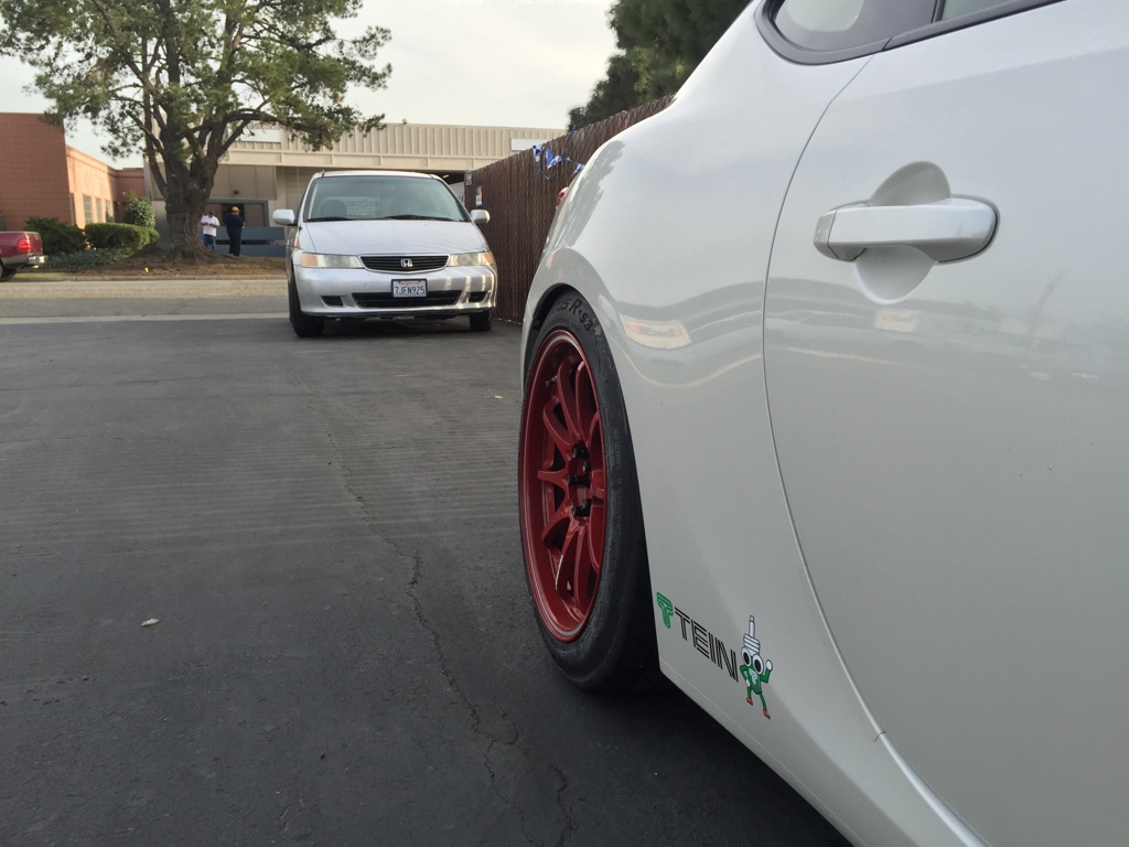

xero404 02-12-2015 02:06 AM
Need That Tire Advice
2 Attachment(s)
Originally Posted by WhiteChocolate (Post 2129161)
You think 245/40 18 would make the cut?
Its def shorter and I'd probably try that size next time. Heres a pic of the 235/45 Attachment 102397Attachment 102398
