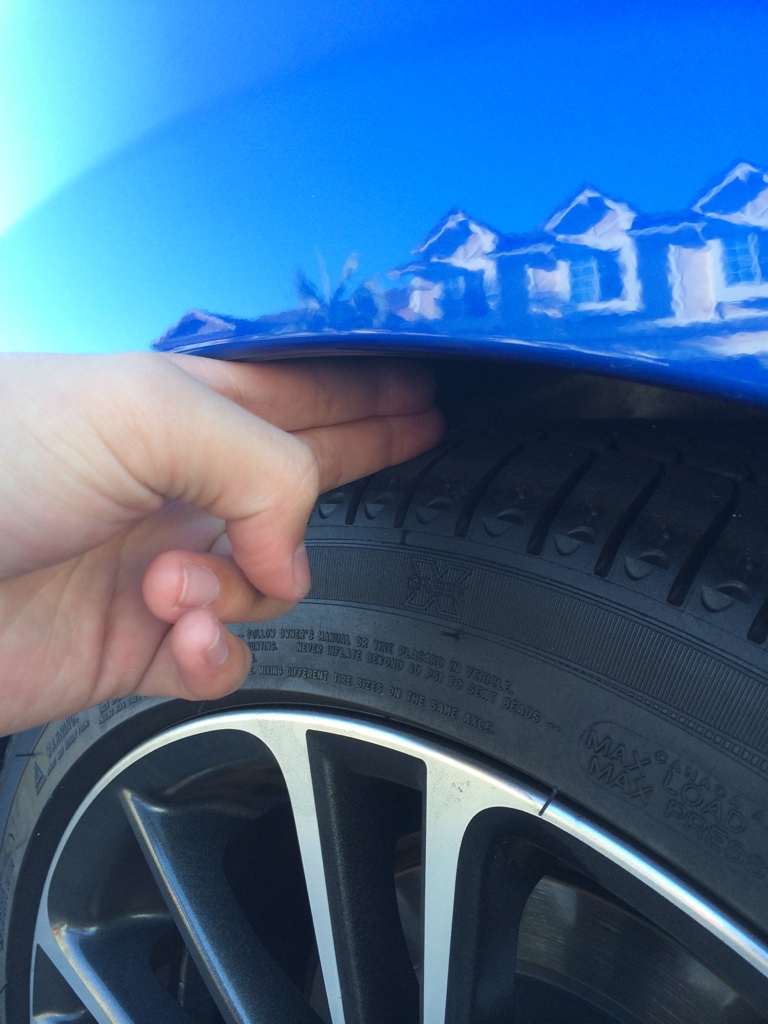

kyoshi11 12-24-2014 04:24 PM
Get some swift spec R springs. They lowered me to about 2 fingers
kyoshi11 12-24-2014 04:27 PM
Attachment 98940
