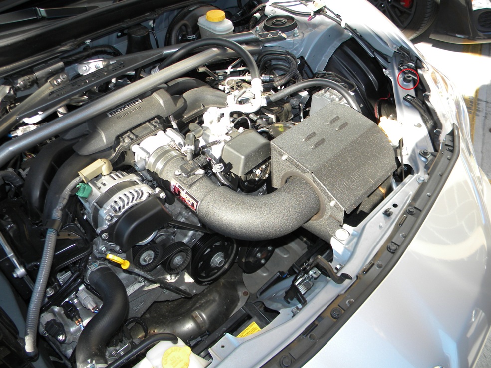

I was in an accident in the beginning of October (thread here) and I just got my car back from the shop. I'm not entirely happy with the results. Though, I don't know if I'm just being picky or if my concerns are legitimate.
My main concern is that when I'm going faster than about 60mph, the hood on the drivers side (where the damage was) comes up maybe a quarter to a half inch. It's a little difficult to explain, but it's because the hood isn't quite flush with the quarter panel and it lets air get under the hood and lift it up.
Also, the gaps running the length of the car on either side of the hood (between the hood and the quarter panel) are wider than they used to be.
And today I just noticed that when I have the hood popped, the front is definitely not symmetrical.
Also, where the front bumper meets the quarter panel (just to the right of the headlight) things don't line up quite right.
I've attached a couple pics to show you what I'm talking about. It seems like the whole right side is just lower than it should be and it's causing all of these problems.
I've already taken the car back once and pointed out most this stuff out. I hate to be that person, but I'm debating taking it back again. What do you guys think? Am I being picky or are these things I should just live with? The car only has 13k miles on it. Any input is appreciated.
D_Thissen 11-28-2014 08:41 PM
It almost looks like the body shop used your old hood (if that's even possible to fix). I would take it back and complain. There is no reason your car should be less than perfect!

Those gaps looks brutal. If your car had any sort of frame damage that could've tweaked the frame, then yes, some panels will be impossible to line up correctly. If it was a small accident, fender bender type, I don't see an excuse for all the misalignments.
FTEIGHTSIX 11-29-2014 05:22 PM
Make them replace the hood.
Prep.
Paint.
Blend.
Colorsand&Buff.
They took shortcuts and should've replaced the hood that they clearly did not replace.
Your front bumper might be sagging because they used the old one also since it's all push in tabs and clips that hold the bumper in other than 4 bolts.

Yeah, I probably never should have accepted it in the first place. To those wondering about the hood and bumper. Both were entirely replaced. They didn't use any old parts. At least that's what I was told. My insurance ended up paying about $6500 for all of the work.
They also said that I didn't have any frame damage. I kind of wonder though, because the whole right side looks like it's sort of drooping a little.

I work at a body shop and I would take it back. First of all the car shouldn't come back brand new obviously but it shouldn't look or do that. They would also not take the "cheapest way out" because they want more money so they should have replaced it with a new hood and bumper. I know our shop doesn't scam people because we wouldn't benefit anything by doing that. They also might have had a bad tech work on it. I would ask if the head technician could adjust it.

I took it back to the shop on Tuesday. The owner said he thought it was an issue with the hood and that it might be defective. He said he was going to call Subaru and see what the options are. Still waiting to hear back from him.
I made a video that shows what he thought the issue was. The hood is very wobbly and moves about quite a bit. Even when you prop it up, the other side just droops.
He said he went with an aluminum hood to keep it as close to factory as possible. He said we may be able to get a steel hood though.
Are ya'lls hoods this wobbly/flexible?

What does the structure look like on the underside of the hood (what the insulation is covering)? I doubt that's an OEM hood - mines nowhere near the wobbly. Then again, maybe the hinges are installed incorrectly / not torqued properly.
And if they're offering you a steel hood, they're definitely not using OEM / Subaru parts. The original hood is aluminum, and they are supposed to replace with factory new parts.

Do not go with a steel hood (if it's even available). Way too heavy and that weight will make a difference in handling. Obviously this guy does not know much about this car, or even Subarus in general to even make a suggestion like that.

Tell him to use oem parts and not cheap non-oem parts there lies your issue. That thing looks like its garbage are hoods are not that flimsy sounds like they used cheap parts and just pocketed the rest of the insurance money.
