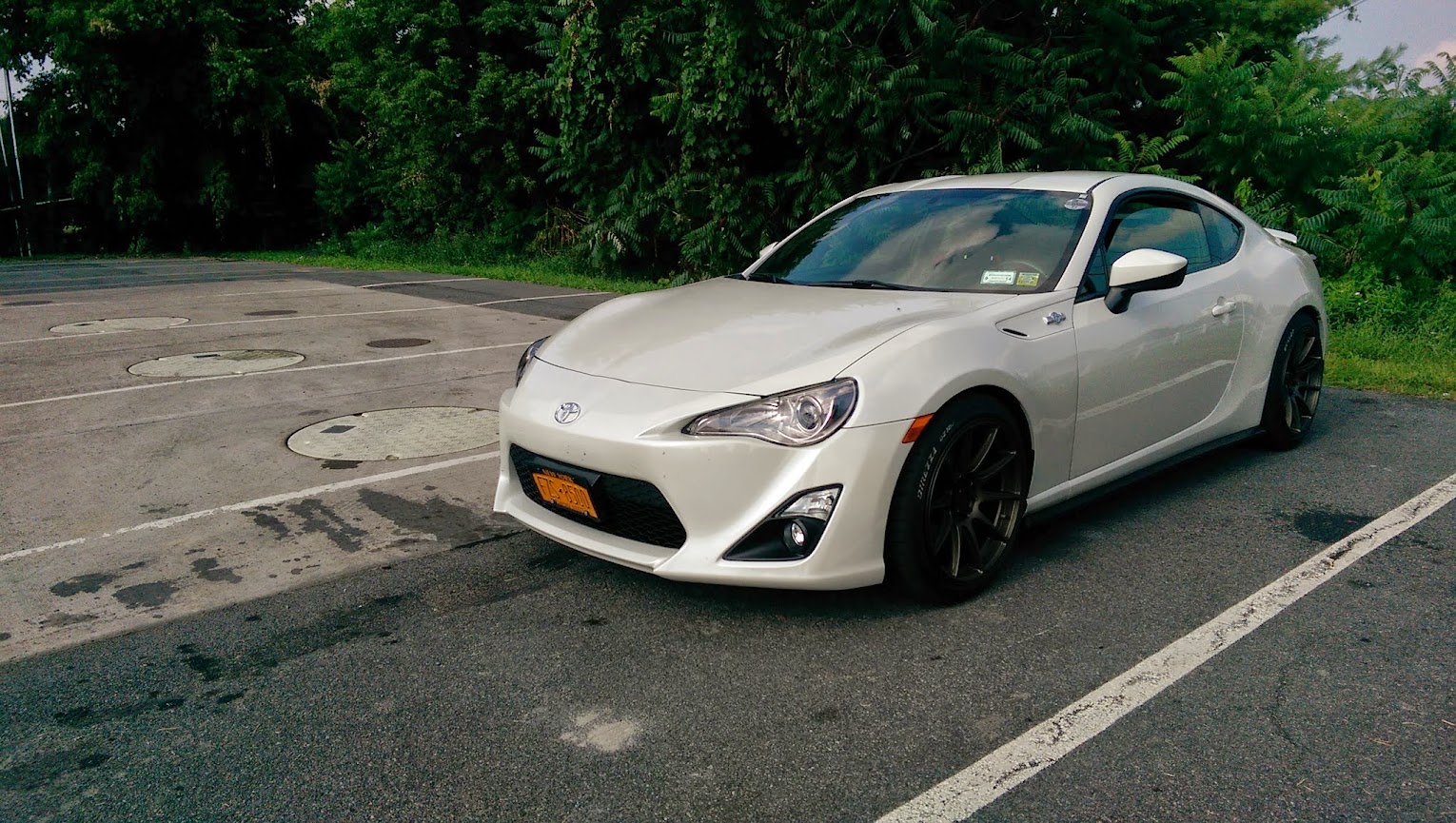

Takumi788 07-21-2014 10:34 AM
Time flies
Time flies when your having fun. Just accomplished this on my way back from a touge run yesterday. 7/20/14
https://lh3.googleusercontent.com/-V...0+16.43.15.jpg
