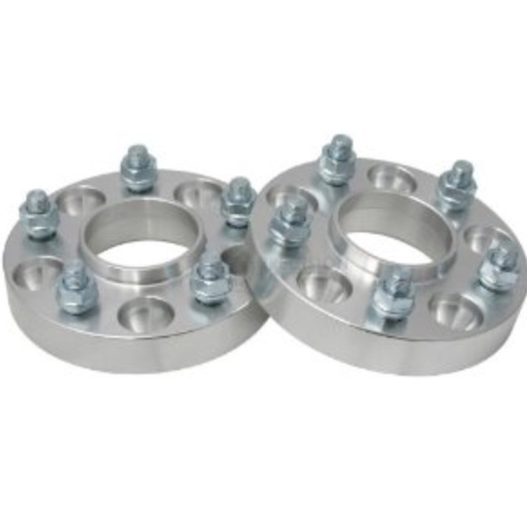

So I recently got spacers and the spacer sits flush on the hub and from what I an tell the wheel is sitting flush against the spacer. But when I drive, I can see my wheel wobbling on both sides. Any reason why this would happen?

They are. But I have have figured out the problem. It looked like when I bolted my wheels onto the spacer. It looks like my wheels are against the lug nuts. Do they offer shorter luts to hold spacers?

Did you read the thread? Hubcentricity is fine, the spacer's lug nuts are too thick and are hitting the backside of the wheel, preventing it from sitting flush.
I had the same issue with front 20mm spacers, about 3/16 wobble side to side. I ended up shaving my lug nuts down a couple mm with a Dremel and a fiber cutoff wheel, Checked them each with a caliper, and rounded the outer corners slightly. It took some time but worked great. My snow wheels are steelies, and the steel is stamped into shape. They have a relief stamped into them between the holes, but the edges of the relief are rounded (not machined) and hit the lugnuts. The rear is a 25mm, and the lug nuts are just below the surface so no prob there.
I'm thinking that's what it's coming down too. The only thing I'm worried about is shaving to much and ruining the thread or the steering the nut.

If you do have to go this route, honestly I wouldn't worry about it too much. If you're only removing one or two threads worth, it's not really going to make a difference in holding power. Second, the direction the nut threads onto the stud is such that all the good threads will be engaged first, and the last thread that was cut will be pushed outward as the lug is tightened, so no debris should be caught between the threads. Also, the nut is steel, so you'd have to REALLY botch it up to make it unusable...
You could also clamp the nut in a vise and use the cutoff wheel back and forth vertically to shave a little bit at a time, or use it like a meat slicer and shave off a section in one swoop. If you're good with power tools, you could use a bigger angle grinder and gnarf off more at once, and then finish with a Dremel.
