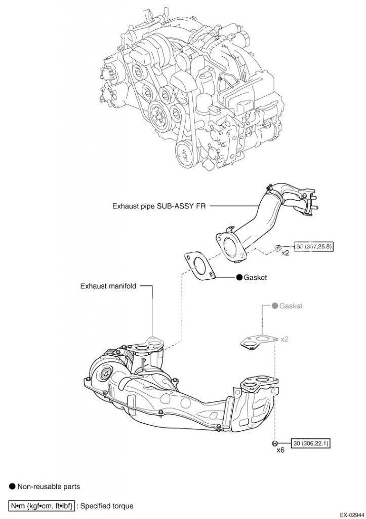

Nice thanks for the feedback. I read a few things about a header. What is that exactly? I thought it was apart of the Exhuast system. And will a tune destroy any warranty i hope to get on the car? I've read before that it could do that.

the header is the part of the exhaust that bolts directly to the engine. an aftermarket header vs the factory exhaust manifold will provide better flow, and from what I understand, is the most restrictive part of our exhaust system, so upgrading will provide the largest power boost(after the car is tuned for it). to answer your other question, depending on the type of tune, and the dealership, you may have to fight to have warranty work done if they find you have a tune.

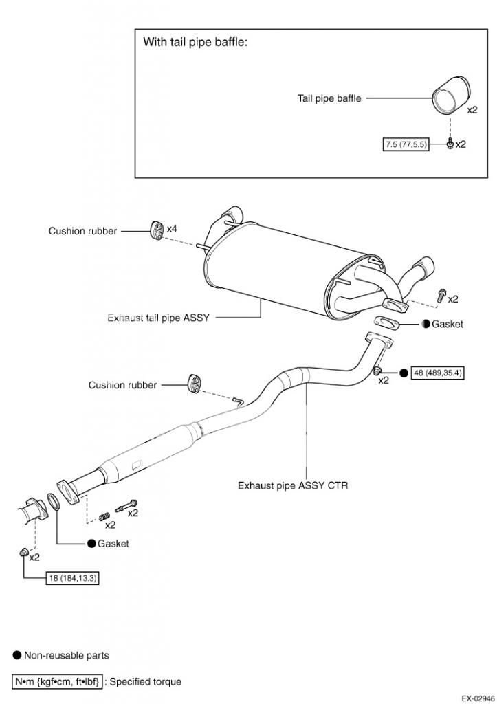

JG: Unfortunately Youtube is blocked so i can't watch any of the vs videos for now. Is a OFH a header or some tune needed for my header? I tried to read an article on it but the acronym's are insane lol.
no problem, It can get really confusing. the OF"H" stands for Open Flash Header, it is the exhaust header. The OF"T" stands for Open Flash Tablet, and this is the tablet used to flash or upload the tune to your car. The company started by making the tablet, and later started producing the header. The same company makes them both, that's why you can get a discount for buying them both. I would provide a link to the page but it is blocked on my base, so you probably couldn't see it either.

Ok cool so it is a header. I was confused. So i don't even have to buy the whole exhaust system. Just the header and tips :thanks:

Maybe it would help you to see some diagrams of how this is put together. These are from the factory service manual.
http://i315.photobucket.com/albums/l...dog/Header.jpg
Above is the stock header (exhaust manifold). It looks fat in the diagram because the heat shielding is hiding a catalytic converter. Without the shielding on it, it looks like this:
http://www.tune86.com/sites/default/...05/header2.jpg
I borrowed this pic from Jeff Perrin's excellent writeup about the car at Perrin Performance. Read it!
One thing you'll notice if you look at the pics of the Open Flash Header is that it doesn't have a catalytic converter. On the product page it actually states that it's for competition use only. Can you get away with running a car with a cat removed in California? (I phrased it as a question because I really don't know.)

Finally, here's the rear:
http://i315.photobucket.com/albums/l...earExhaust.jpg
So now you can see some of your choices. There are replacement parts available for almost every part in that system. There are louder mufflers. There are bolt-on muffler delete kits available for people who track their cars. There are replacement pipes that remove the cats altogether. There are replacement cats that are less restrictive, including headers with better flowing cats built in. There are all sorts of replacement tips that can make the car look cool or stupid depending on how bad your taste is.

Wow, Yes that does help a lot! Thanks a lot man i really appreciate the post. Seeing the pictures of it really does help in understanding it a little more. I put in bold what you said about some forced induction setups because I am really looking into the ESC setup that was linked here, but i like the idea of a UEL header better. I know that ESC doesn't create as much of a boost as a full blown turbo system or supercharger would produce so i'm wondering if I would still be able to get the UEL header. Thanks a lot guys :coolpics:
