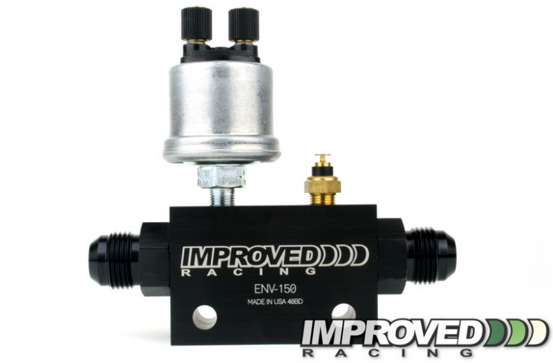

mrk1 03-24-2014 04:47 PM
An inline sensor manifold is another option, mount this on the hot side going to the cooler. Preferably as close to the motor as possible.
http://i139.photobucket.com/albums/q...psd6dea629.png
Im trying to reduce the amount of Tee's and adapters needed since every connection is a possible leak.
King Tut 03-24-2014 06:20 PM
Never seen one like that. Great idea since he is running an oil cooler.
Thanks for showing this. $60 isn't much to pay to reduce the amount of potential leak points.
