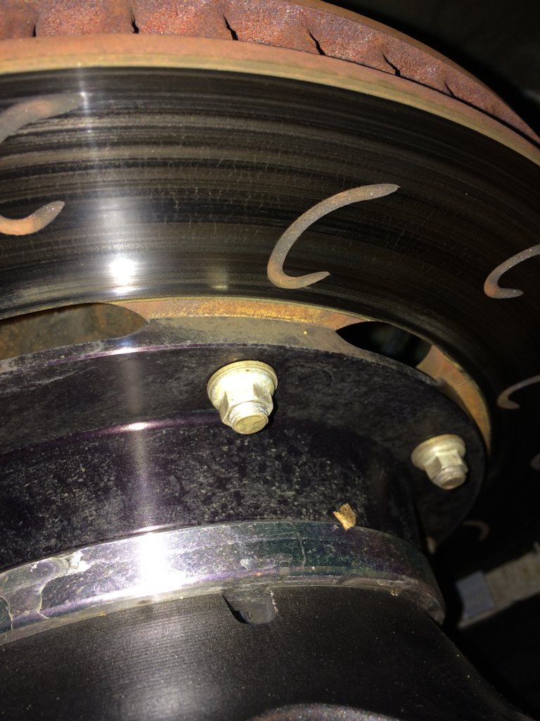

MINOCIN 03-10-2014 02:19 AM
Well, the brake pads are no longer rattling around inside the brake calipers. They are now firmly pressed against the rotor and I can't move them with my finger anymore, even when everything is cold. So no more rattling noises when driving around town on bumpy streets.
What changed? Well, I finally got around to trying to bed the brakes.
Last night in the middle of the night I found a long and empty highway and I drove for almost 3 hours trying to bed the brakes. I say try because I'm not quite convinced that I was able to pull it off. I tried to follow the instructions provided by essex in there videos:
http://www.ft86club.com/forums/showp...5&postcount=14
Here are some pics of the rotors.
https://dl.dropboxusercontent.com/s/...2013.45.19.jpg
https://dl.dropboxusercontent.com/s/...2013.45.03.jpg
https://dl.dropboxusercontent.com/s/...2013.45.12.jpg
https://dl.dropboxusercontent.com/s/...2013.45.50.jpg
(In the above pic you can barely see how the brakes must've bled a bit during the bedding process. It's easier to see in person)

dradernh 03-10-2014 10:57 AM
Originally Posted by MINOCIN (Post 1586770)
If the brakes are too hot, to the point where they are fading, then they will squeal on any and all brake input until they have cooled down some.
When attempting to bed the brakes I never triggered the ABS, but I definitely feel like my tires were not quite up to the challenge.
So I guess the lesson here is, "beat on your brakes kids."
Rotors look fine, and most of what you're saying is spot-on.
I do wonder, however, what it is you did to get the brakes to fade. Can you share? Edit: Oops, saw Mike's post - forgot you were on the S100s, thought you were on the C300s.
Yes, you have more brake than tire.
No, the lesson is: bed your brakes in properly. ;)
Congratulations on succeeding!

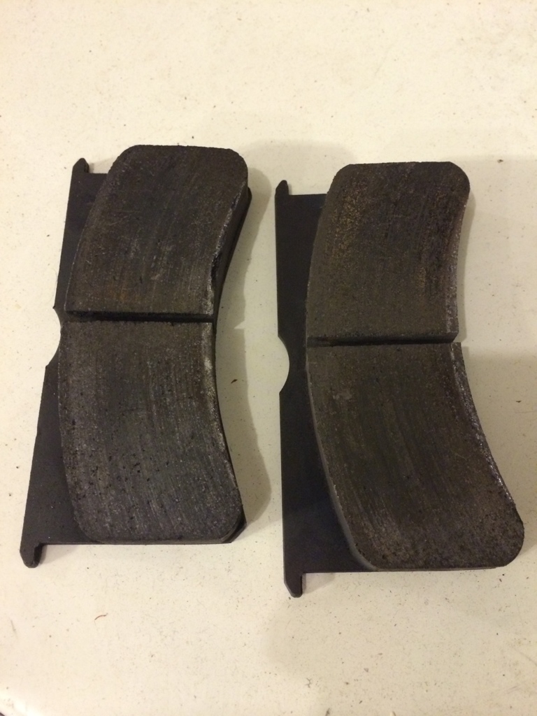

dp1 05-07-2014 09:59 AM
I have the Sprint BBK and use Carbotech bobcats for street and XP12 for track. My inner pads are developing a 2mm lip on both sets, and they squeal pretty loud when coming to a stop, when warmed up, including bobcats. I bought both sets in correct sizes based on recommendation from @CSG Mike, and they fit well when mounted. Anything I can do to remove this inner pad lip forming behavior, or should I just file that outer edge and live with this because racecar? It seems like the center cylinder piece that holds the pads in place could be a little larger to hold the pads in place better...please advise, thank you
CSG Mike 05-07-2014 12:56 PM
I'm not 100% sure on trying to mentally visualize the lip you're speaking of. Can you post a pic please?
dp1 05-07-2014 10:41 PM
AP Racing Brake Kit - Loose Pads Rattling Inside Calipers
I was wrong, it's the inner edge (closer to the center of the wheel) of both front inside pads (closer to the wheel well) that are getting the lip. Anyone else getting this with Carbotechs? This is probably causing the squeal when they warm up.
I see a very thin lip on only one of the two front outer pads. Both inner and outer rear pads look evenly worn on Stoptech slotted rotors.
These are XP12 pads but bobcats have the same wear pattern.
Worn area measures perhaps a hair over 1.5" wide and the total width is about 1 5/8".
Attachment 77786

dp1 05-10-2014 10:01 PM
Originally Posted by CSG Mike (Post 1723120)
Let me e-mail that over to Carbotech...
Please let me know when you hear back from Carbotech. I don't mind chamfering off that lip every once in a while when I swap pads between street and track. It's interesting that this only happens on the inner pads, outer pads wear evenly across the pad surface.
dp1 05-19-2014 10:37 PM
Same exact lip is now more pronounced on the inner front XP12 pads after couple of track days. I noticed that the only reason this lip does not exist on the outer pads is because the metal pieces that connect the replaceable ring to the middle part of the rotors (connected with bolts) only exist on the outside and they are shaving off that edge.
It looks like the curve is off (should have smaller radius and cut more in the middle).
I chamfered the bobcats and the squeal is gone. Hope they fix this as I love Carbotech pads, but my patience with having to take them out and chamfer them to lose the squeal will wear off eventually, as much as it takes less than half an hour to do...
Please let me know what they say or if I should contact them directly. I believe others had noisy Carbotech pads on the Essex Sprint AP BBK.
Thanks!
Attachment 79340

dp1 05-20-2014 07:57 AM
Originally Posted by CSG Mike (Post 1747941)
CT replied back that the rotors are likely slightly expanding and setting, and that the pads, once grooved, just sit int he same spot, resulting in the lip.
Getting blank rotors, instead of hooks, will be MUCH quieter.
Do you know what temps your rotors, pads, and caliper are getting up to? Do you have ducting?
I didn't measure rotor temps (was focused on tire pressures, will do next time on track, have a pyrometer) and no ducting. Will get blank rotors next time. It may take a little while as Carbotechs seem to be pretty easy on the rotors.
After chamfering off that lip my bobcats quieted down completely.
