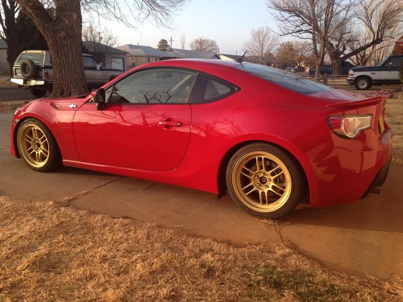

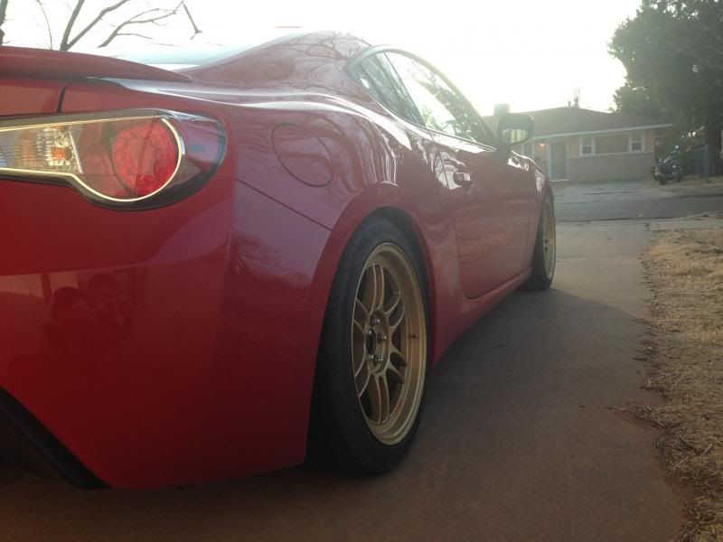

I run 17X9 +45's with 235/40's and run a 3mm spacer in the back. I think the car looks perfect. I will probably step up to 245/40's next but with the 235's on the 9" wide I can get her side ways for some decent power slides on the odd occasion.
