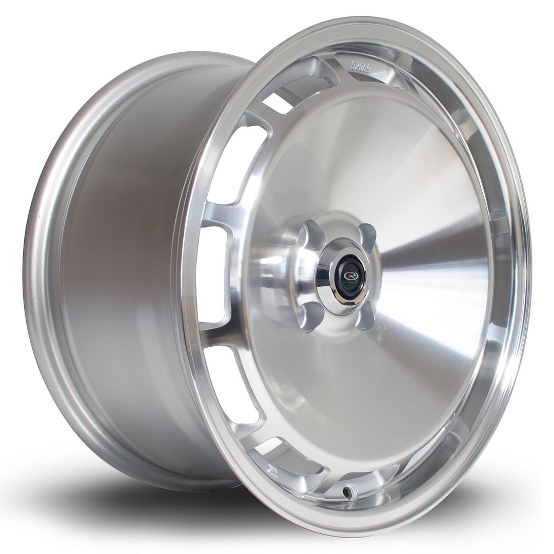

There's also a new release by ROTA wheels, pretty darn cheap at under $200 AUD per corner, probably cheaper in the states where you are. They are obviously SprintHart CP-R knockoffs but look good and have that classic stepped lip on them.
http://www.rotawheels.com.au/media/m...-20_-20_c1.jpg
btw, I don't usually like rota's but these would be good for some cheap, relatively light track wheels(7.3kg - smaller diameter wheel so cent. forces are different.. less mass toward outside - more on inside). Or just daily's you don't care about. Plus genuine CP-R's are hard to come by - 16x7's weight 4.9kg derp
