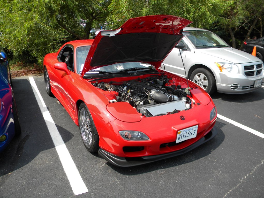

After building an LS1-powered FD and seeing the kits we used (supplied by Samberg or Hinson being the most popular), I'm not a fan of the design of the WGP setup. The kit looks rather bulky and heavy (reference the tubular setup produced by Samberg) and not friendly when it comes to working on the car.
For anyone that's considering doing this swap, you have to look at the whole picture aside from just the cost and weight. Do you plan to use the factory GM ECU and if so, are you going to rewire the entire car? Do you plan on keeping A/C? Who's going to make the custom lines? What steering rack will you use and how will the position of the motor effect bumpsteer and handling? What differential will you use? I haven't read up on our differentials but I'm going to venture out and say they probably survive very long being abused by torque.
Based on my car, I would bank on easily spending ~$15-20k with a timeline of 1.5-2 yrs, maybe longer, before it's completed. Can you do it for less and in quicker time, sure but for a proper, cleanly assembled setup, it's not a project anyone should rush.
With all that being said, I wouldn't elect this car for this time a build. Find an RX8 with a blown motor for cheap and venture into that. Why the RX8? It has a very neutral handling setup and would be a great candidate for the swap based on completion cost.
**EDIT** After looking at the WGP kit, the larger steel pieces maybe the tooling which makes the kit not as bad as I thought when I quickly view the pics.
