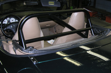

old greg 05-07-2012 07:10 PM
Originally Posted by RiskyTrousers (Post 203469)
So whats a roll bar?
A safety device intended to prevent squished heads.
Attachment 7155
