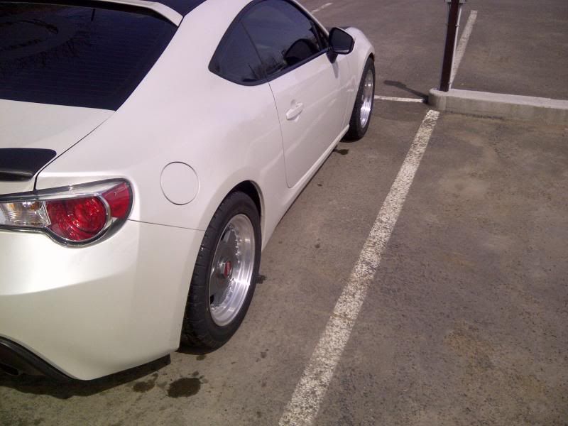

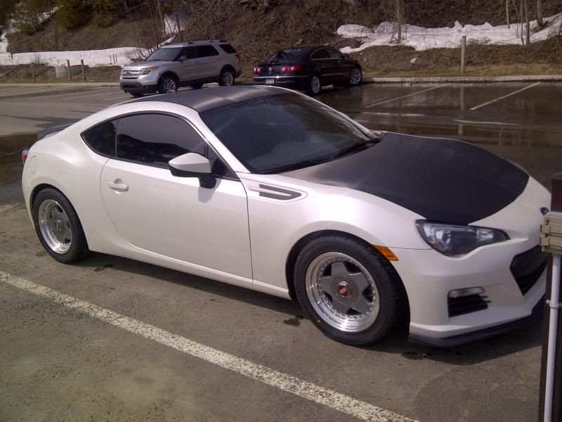

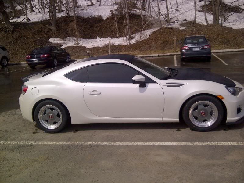

Walla Walla 04-11-2014 02:05 PM
summer is at our door... (well.. almost)
so here are the first pics!
http://i5.photobucket.com/albums/y16...ps49fbbd77.jpg
http://i5.photobucket.com/albums/y16...ps2c10ca56.jpg
http://i5.photobucket.com/albums/y16...ps5f7d4c0d.jpg
