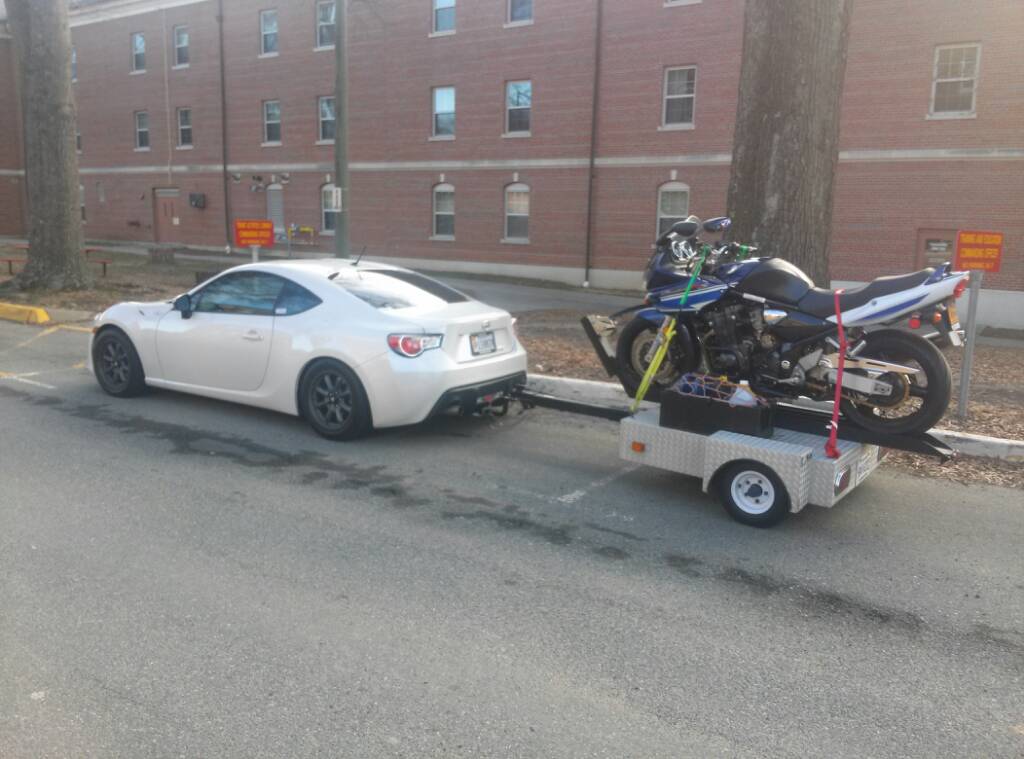

leon78 03-04-2014 08:35 PM
Attachment 69206
The rig
Sent from my LG-LS970 using Tapatalk
bobaab 03-04-2014 09:53 PM
Looks good! Is that a Bandit 1200?
leon78 03-05-2014 07:07 AM
Thanks, and yes...2005 bandit 1200, last year for the air/oil cooled.
