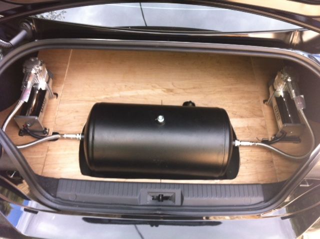

It took me about 18-20 hours to install Air on my FR-S. I've done my fair share of lowering cars (about 10 on springs). I had the actual airstruts on 1.5 hrs. It's running the wiring (removed passenger seat, backseat, trim on bottom of door, trunk floor), mounting the compressors, making something for the relay's and tank to sit on, making a false floor (1/8" plywood wrapped in black duck cloth). Then getting everything set up and installed, running lines checking for leaks (fixing leaks). Adjusting the struts for ride/stance preference. I'm sure the shop is giving you a little high of a qoute but installing air isn't the same as putting on coil overs or lowering springs.
I could have gotten it installed in prolly half that time if I just threw everything (managment system) in the trunk, but I prefer to have it look well done and be able to return the car to stock (if needed).
Pic: Before the fabric was put on.
