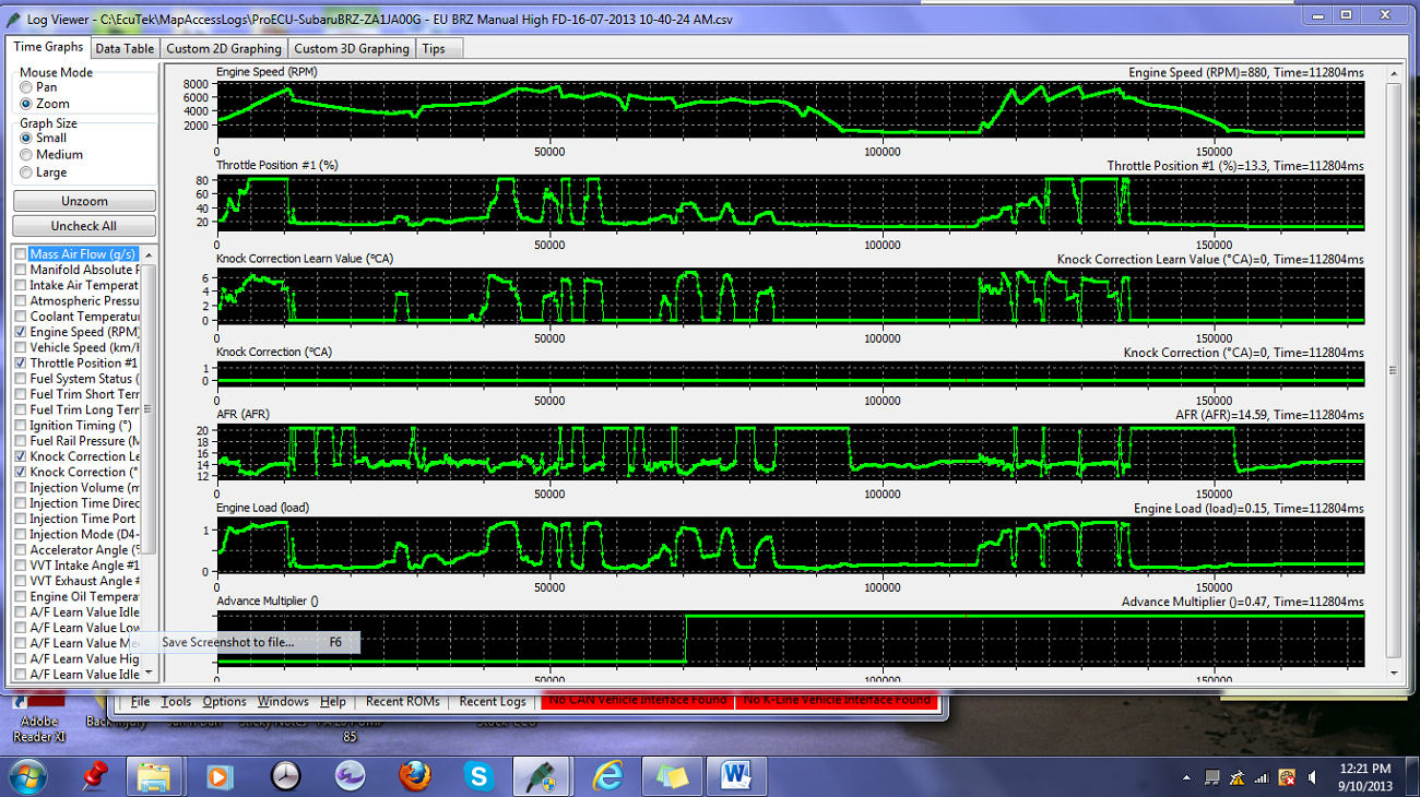

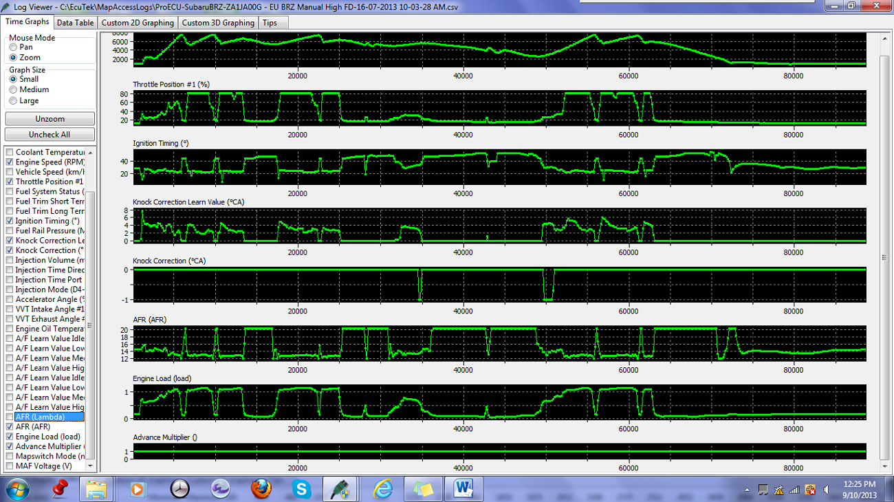

cuddefred 10-09-2013 12:01 AM
2 Attachment(s)
Ok, here goes. As the original post suggests, I am one who has very little tuning knowledge and have such have placed my faith in a couple of Ecutek tuners. Attached is a log from each and any interpretation by those who know about these things would be appreciated. :cheers:
Attachment 53644
Attachment 53645

I don't understand the dip in throttle position.. I had it WOT up to 7000. Is physical throttle position different than this parameter? I see a correlation with ignition timing, but I don't know what that means.
feldy 10-13-2013 10:40 PM
If you look at engine load its doing the same thing. Ill look at mine tonight and see if its the same. Weird but maybe not
jamesm 10-13-2013 10:53 PM
there's a lot more than just throttle position that goes into calculating target throttle plate angle in any given situation. a simplification is to say that requested torque is resolved from a 3-dimensional map of accelerator pedal angle and rpm, which is then used in another map to look up a target throttle plate angle. in reality it's more complex than this, with other maps involved that i don't understand. point being you can't expect a steady input to result in a steady output.
whitefrs 10-13-2013 11:05 PM
Here is mine
Jr tuned
Full Blown e85 tune
Idle
Cruise
3rd Gear Pull
