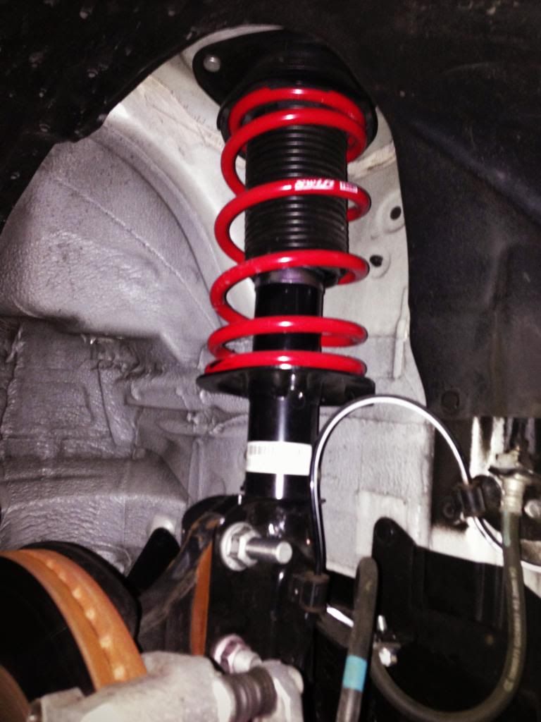

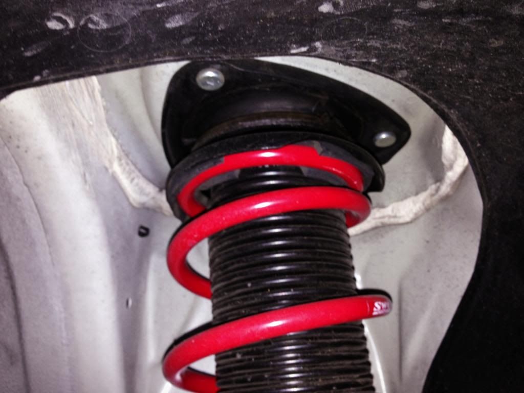

Passenger Side Front:
http://i174.photobucket.com/albums/w.../IMG_43421.jpg
http://i174.photobucket.com/albums/w.../IMG_43361.jpg

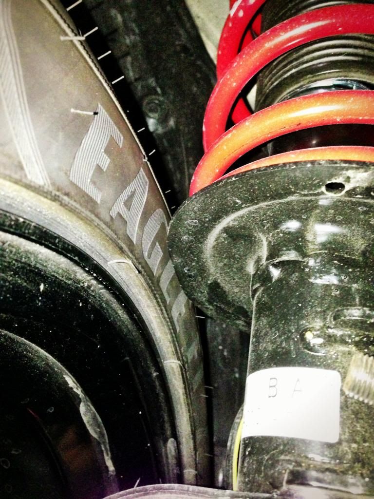

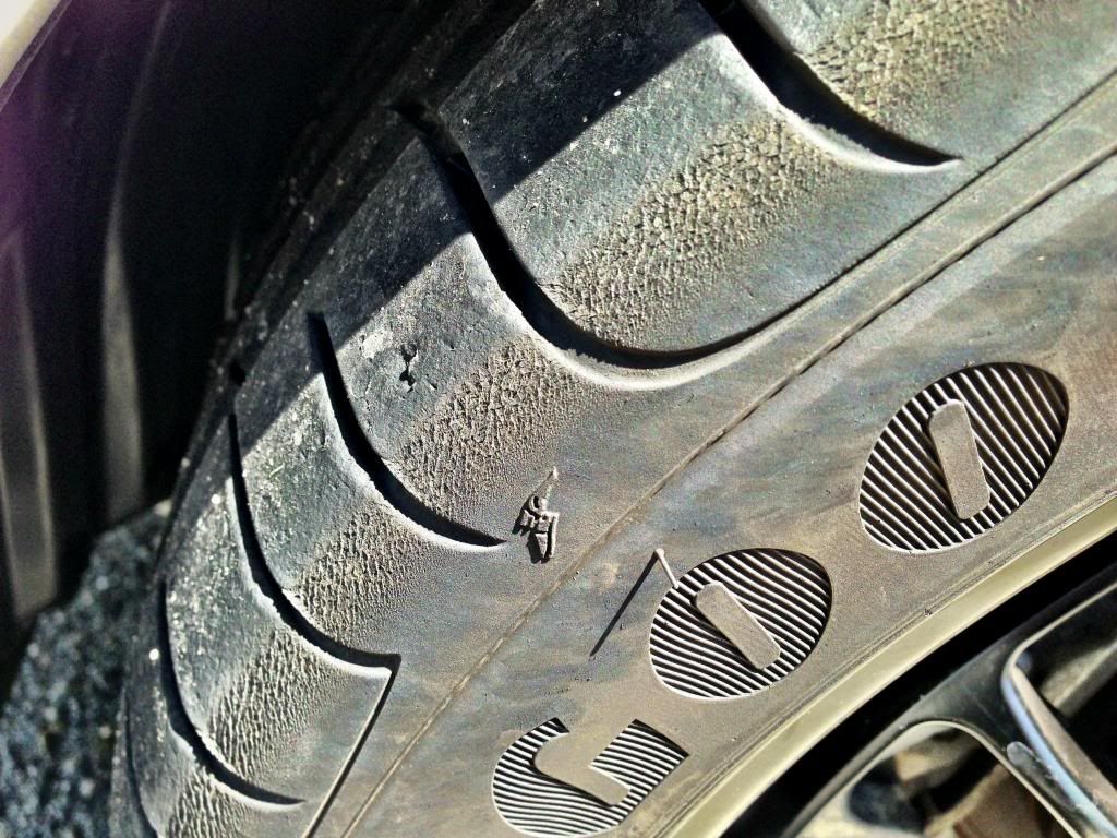

Tire marks on front coils:
http://i174.photobucket.com/albums/w.../IMG_43371.jpg
Front clearance with tire. My index finger feeler gauge was pretty accurate. abt 3-4mm clearance at full droop.
http://i174.photobucket.com/albums/w.../IMG_43401.jpg

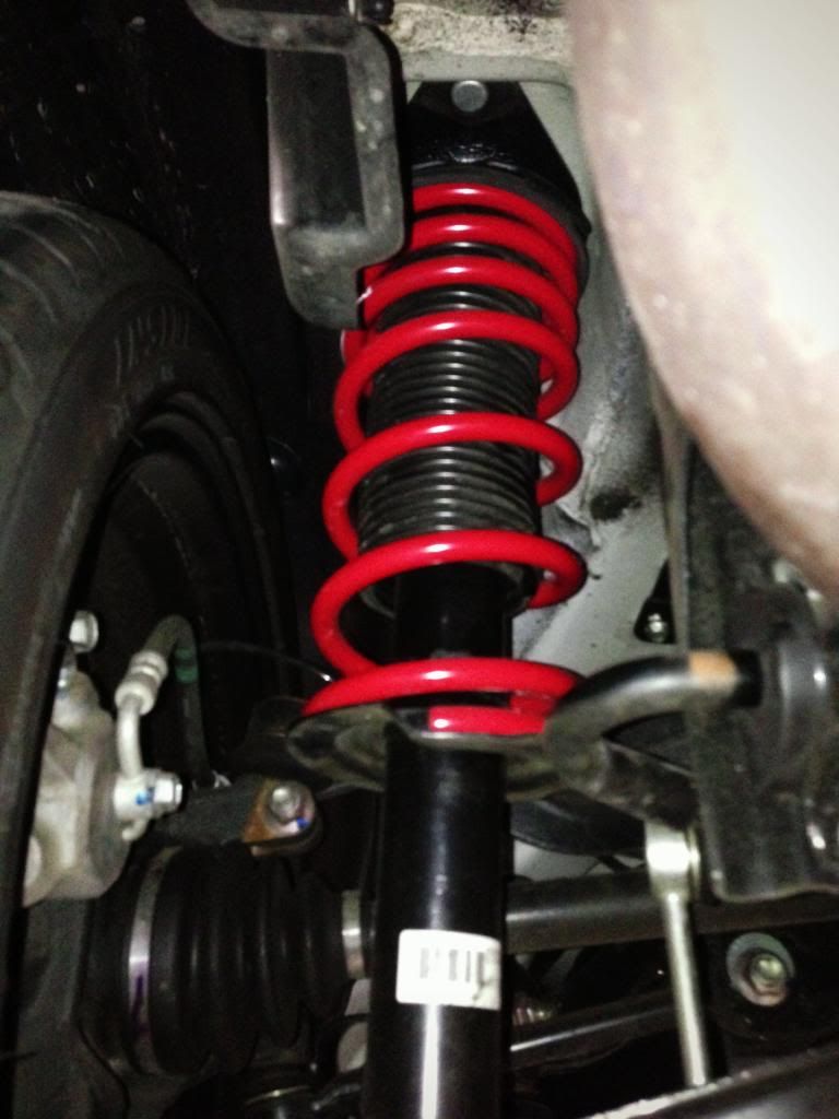

Driver side rear:
http://i174.photobucket.com/albums/w.../IMG_43411.jpg
I'm hoping a 5mm spacer will let me add some more camber using a second set of camber bolts on the strut bottoms while eliminating the tire contact with the coils. May have to go 8mm spacer...
diddy 08-31-2013 08:28 AM
Originally Posted by solidONE (Post 1180114)
On my rears, there is no gap between the top coils of the spring. The coils are touching each other. Is it installed wrong?
solidONE 08-31-2013 01:49 PM
Did the spring come like that? Also, on the lower spring perch are your springs seated like what you see in my photo?

solidONE 10-31-2013 12:05 AM
Originally Posted by trustyler (Post 1304176)
Oh I missed that. I just got my Swift BRZ springs also. Haven't installed them yet though. How are you liking them as of now? Did it rub because of the offset? Did you need a camber kit as a requirement or just a toe adjustment?
the rubbing is caused by a combination between the wheel offset and negative camber I added from camber bolts. I added more camber by choice, not a necessary modification. You will have less than half a degree of negative camber out front without any camber adjustments. Although, the rear will gain some considerable negative camber. I'm relatively satisfied with them for what they are, just lowering springs on stock dampers. Although I wish I had gone with the FR-S specs or Hotchkis springs over these as I think they would be better suited to the stock dampers than these even if I think I like the BRZ spec spring rates better.
