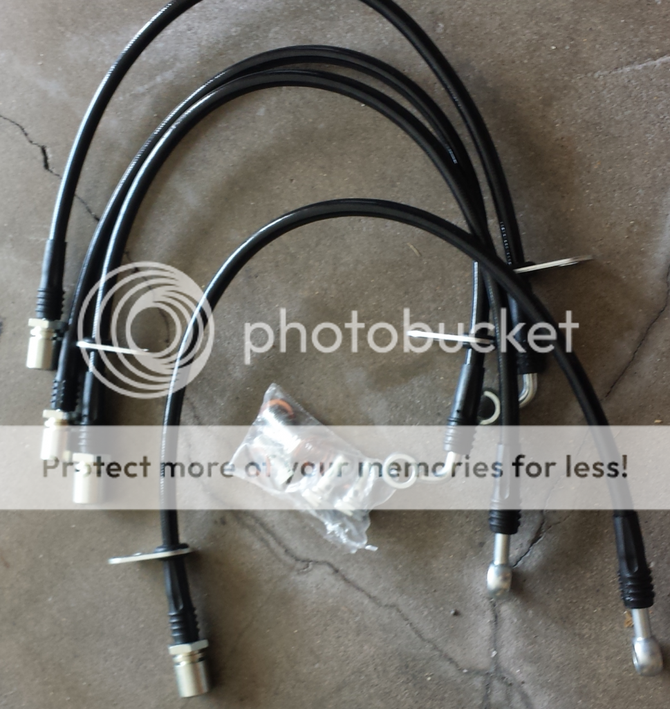

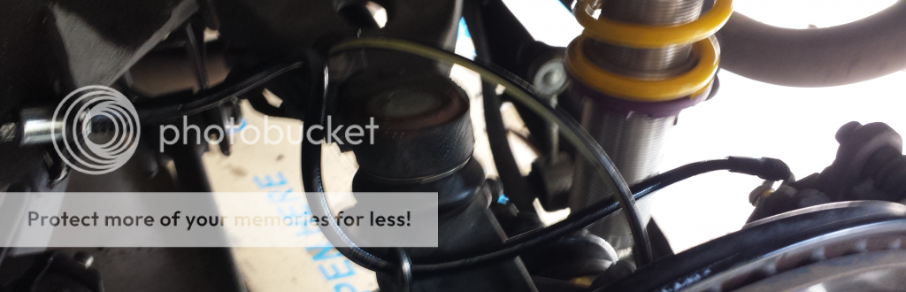

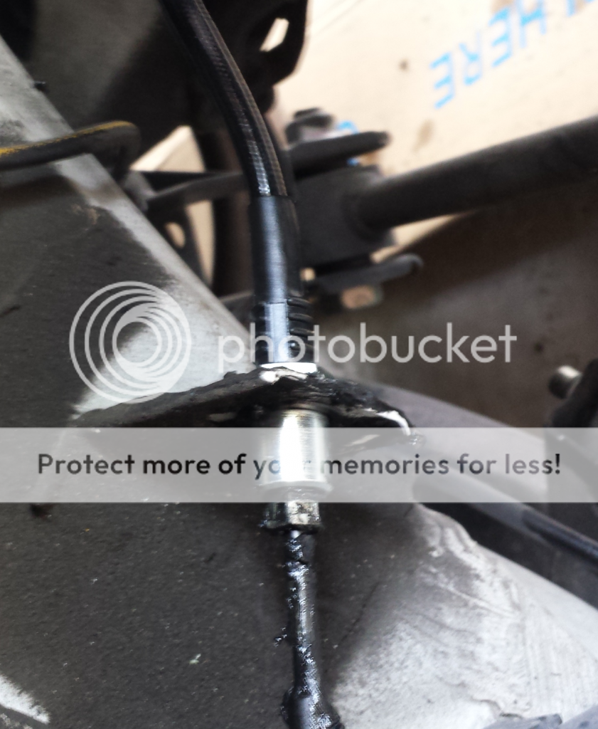

I Installed my ChaseBays Stainless Brake Lines and ATE (now illegal!) Super Blue fluid this weekend. Install was not bad, bought some cheap fluid to refill the master as it gets low from taking the lines off and it leaking till I flushed the system with ATE that afternoon. The black stuff that the factory put over the lines was kind of a nasty mess and was the only thing that really made the job annoying.
Pedal feels a bit firmer and I am happy with the fit and the quality of the lines as they retail for less than the other brands around!:thumbup:
http://i626.photobucket.com/albums/t...pscc1292db.png
Before:
http://i626.photobucket.com/albums/t...ps2d45e138.png
After:
http://i626.photobucket.com/albums/t...ps54229971.png[/URL]
http://i626.photobucket.com/albums/t...psddd535ce.png

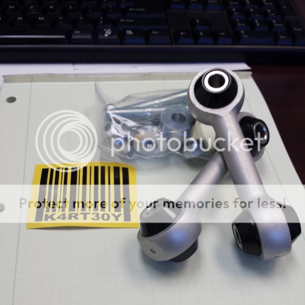

Also, I would like to thank Kartboy, All Wheel Engineering, for sending me some rear endlinks, now I just need bars!

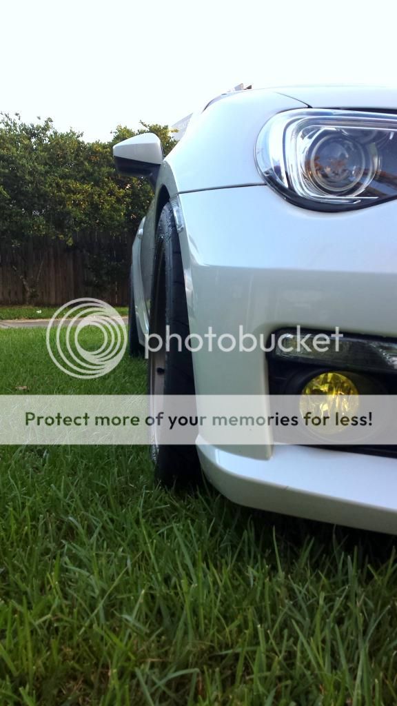

SubiePig 10-04-2013 12:10 PM
First off. I need a tire trailer in the near future. I can fit 3 of these in the front and one in the trunk to the side and still have enough room for a jack, tools, and clothes bag but long term its going to get mighty old.
https://scontent-b-dfw.xx.fbcdn.net/...28629850_n.jpg
Welp, here they are mounted. I drove around town a bit on them last night and they defiantly do what they are meant to, grip.
https://scontent-a-dfw.xx.fbcdn.net/...27875391_n.jpg
Front and side views
http://i626.photobucket.com/albums/t...ps80699fb8.jpg
http://i626.photobucket.com/albums/t...psf1e2ab21.jpg
Next up will be Stranos front sway, endlinks, and a battery.

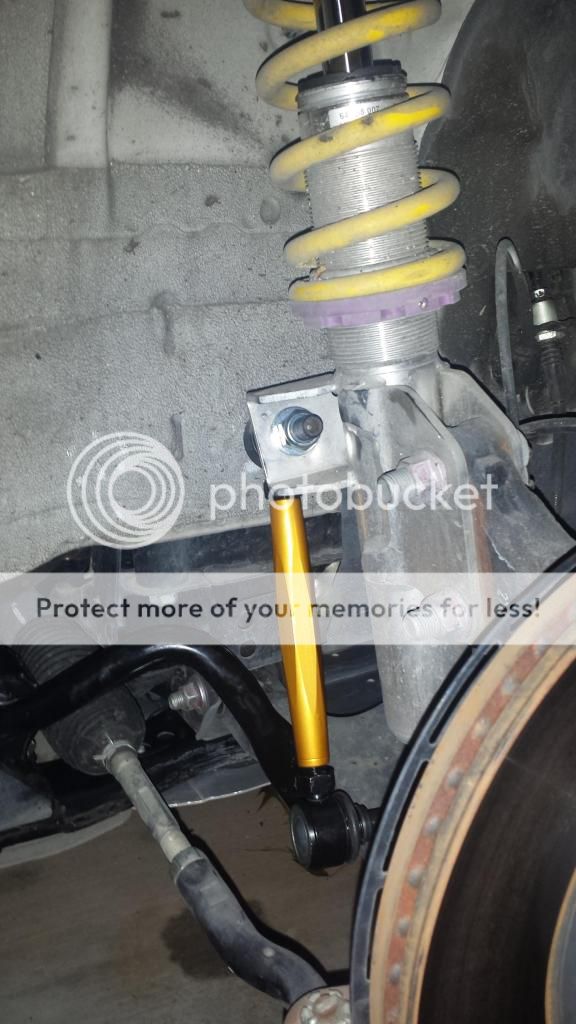

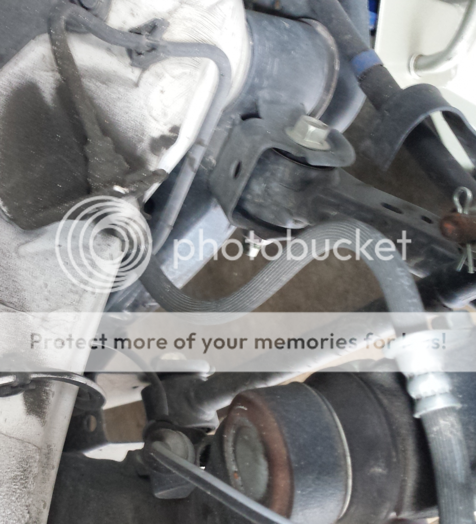

Small update.

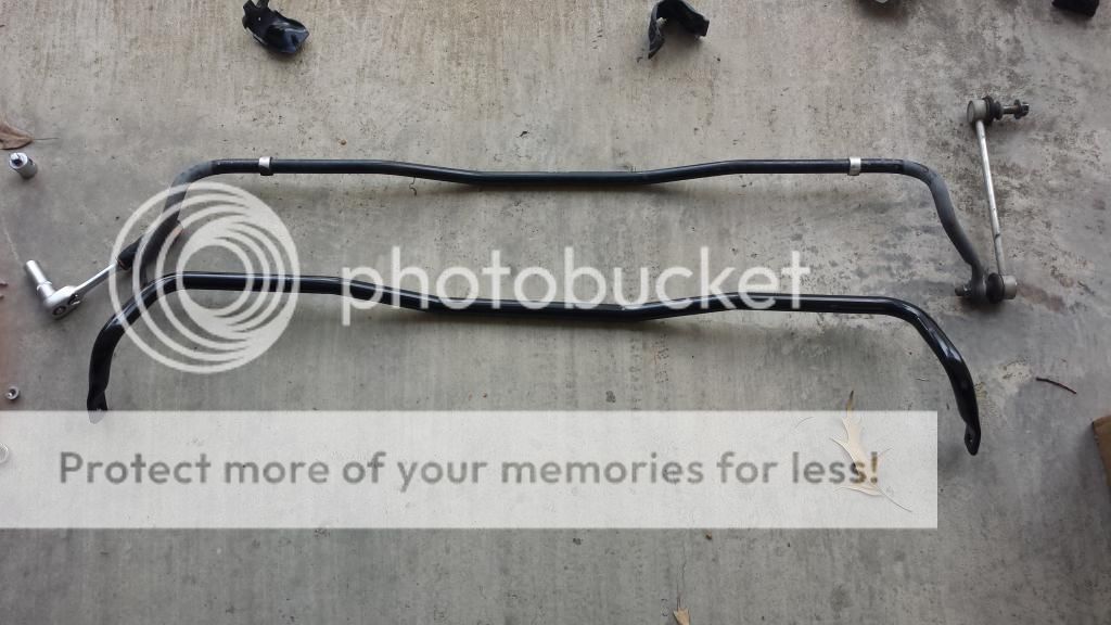

I got my 22mm Bar in from Stranos Parts Saturday and installed it yesterday. Install was very straight forward and doesn't take to long. Only annoying thing was doing it without a lift and take those engine covers off. So. Many. Bolts.
Next event will be this coming weekend in Houston Saturday and Sunday. I didn't get to mess around to much after install as it was pouring down once I got done. Turn in feels tighter, there is a round-a-bout near my work I take every morning "spiritedly" car felt much more planted over the bumpy section in the turn than before and I could get on the power a sooner. Only means good things to come. :)
Difference between the bars.
http://i626.photobucket.com/albums/t...ps1ae1e953.jpg
Starting to look more racecar under here. :party0030:
Note: bottom of endlink wasn't installed yet, I know it looks wrong. :P
http://i626.photobucket.com/albums/t...ps3ee14c66.jpg
I did find some concerning corrosion on the under the metal engine cover. This was on the subframe members that hold the swaybar. For a car with 11k miles this is dumb. Like my 02 WRX control arms all over again. I know Subaru will just replace them and it will do it again. We do Phosphate coating at work... hmm..
http://i626.photobucket.com/albums/t...ps0761e2f7.jpg

Had some clunking from the front end yesterday, one of the lock nuts on the endlink came loose so I fixed that. Still had some noise on the way to work this morning. I saw one person have a problem of their bar hitting the control arms. Hoping this isn't the case, going to jack the car up after work I guess.
Ordered all this today, things just keep getting more serious. :)

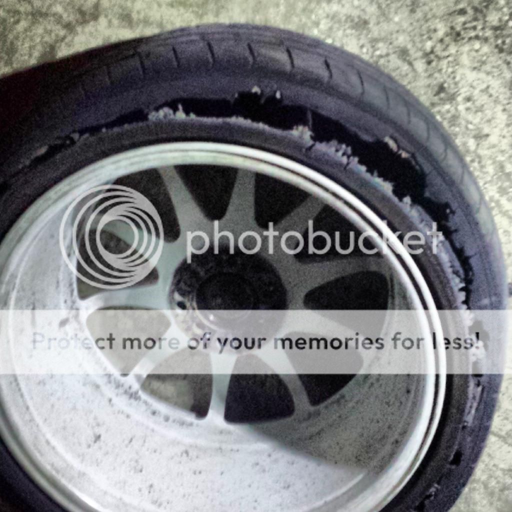

The BAD:
Remember how I said my next thing was to do a more aggressive alignment? Well, I was leaving downtown Houston Saturday night and found my way into a big F$%*ING hole. I had my street wheels on with the RPF1's and tools in the back thank goodness but the Tire was destroyed, and the rim is scrap. It knocked the alignment out in the front a bit as the wheel is to the left a slight slight amount. Just my luck.. Here's a pic of the tire..
http://i626.photobucket.com/albums/t...ps5505a769.jpg
Stevo22 11-07-2013 12:07 PM
Wow that is crazy! Glad you and car are ok.
