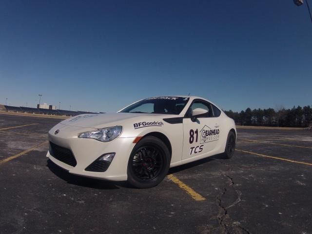

SeanRTR 03-31-2014 12:53 AM
Finally, almost all the snow has melted, and 50 degrees and windy felt like a tropicial gift from god.
Not the best event, with a small sealed asphalt lot, but I got a chance to test my new tire setup,
225/45/17 Rivals up front (same)
245/40/17 RIvals in the rear (new)

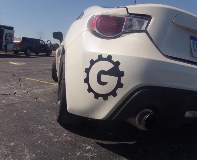

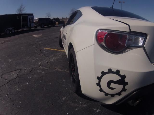

Pictures of tires:
http://i2.photobucket.com/albums/y21...t/GOPR5268.jpg
http://i2.photobucket.com/albums/y21/seanrt/2.jpg
I ran the car with a bit more rear tire pressure and shock than normal, here's the entire setup:
22mm front Perrin bar on soft
225 45 17 BFG Rivals Front 31.5 PSI
245 40 17 BRG Rivals Rear 34.5 PSI
Front Koni's 3/4 turn from full stiff
Rear Koni's 1 turn from full stiff
Ended up first in class by a decent mag6in, and I think I won first on index out of about 75 drivers (results not out yet)
