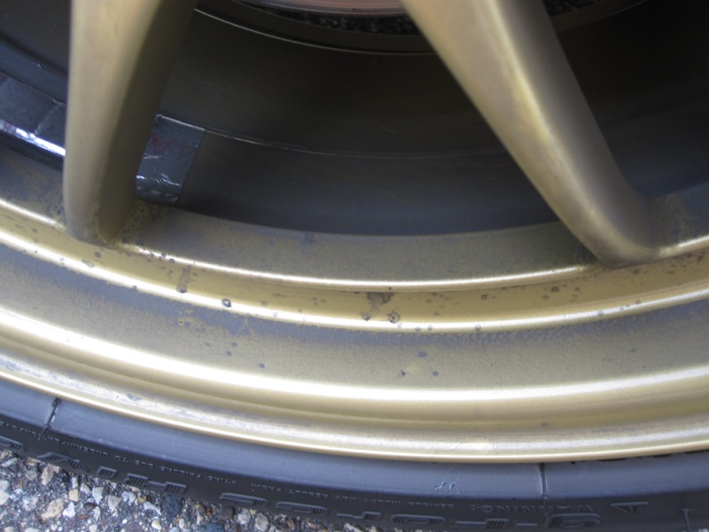

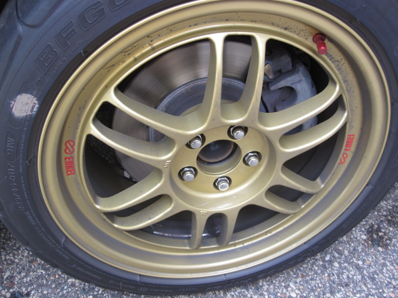

Try the CL RC5+ Addendum

I think this is a good thread for some additional comments on my CL RC6 pads. After seeing track use, they seem to dust a lot more on the street. Either that, or the Enkei wheels I have been using for the last few days just show the dust a lot more than the stock wheels. [Added to the fact that I do not think the stock wheels are very attractive, so I really don't care much about them.]
The dust does seem to be extremely easy to clean off though. A dry microfiber cloth was all that was needed except in a couple of spots that got wet. In those spots, Griot's Garage Spray on Car Wash made quick work of it. The CL RC5+ should dust less as they are made for street use, but I don't think you should expect dust-free performance.
Here are some photos of the dust after about 2 days of street driving with the track-used RC6 pads:
Attachment 41456
Attachment 41457
OrbitalEllipses 06-19-2013 04:59 PM
You're not getting dust-free performance from any pad that's not OEM and low-temp/fade-prone.
