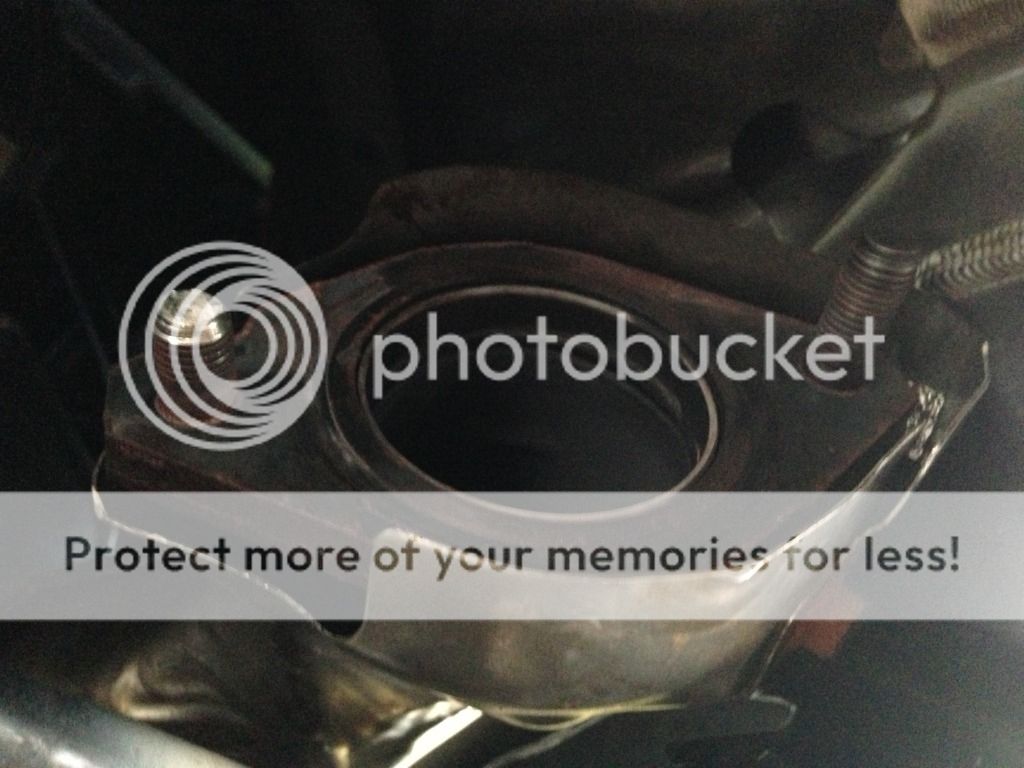

Philly758 07-13-2013 03:47 PM
Happened to me too. I guess I'll remove the overpipe and see if I can tap the studs out and use different bolts. Chances are I will just get this thing prepped for an aftermarket overpipe and install it later this week.

Philly758 07-13-2013 05:59 PM
Well the overpipe is out. I could probably grind it off and drill it out easy enough then use a different bolt.I'll probably just save myself the hassle and buy a new overpipe since its already off the car. The real question is I'm 6 bolts away from replacing the header... Go all the way?
Another pic:
http://i695.photobucket.com/albums/v...psd49ea981.jpg
