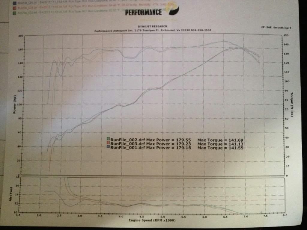

xjohnx 05-04-2013 05:23 PM
http://i.imgur.com/Cdwagsz.jpg
There's mine. Ignore run 3, that was from when I was there in October. Same mods both times, just different revisions of Visconti's tune.
Mods:
Nameless Performance Overpipe/Downpipe/Highflow cat w/ resonator and Axle-Back (Original style, non-offset, 4" mufflers)
Visconti E85 Tune
K&N Panel Filter

vtmike 05-05-2013 12:39 PM
Originally Posted by Opposed (Post 912286)
Have you sent John any logs? I don't see you losing 20+ whp because of the snorkel. I made 180whp on a dynojet with his 93tune and AFE intake only.
This dyno had some strange results. Xjohnx car has made 180whp on e85 with overpipe downpipe combo, with axleback which seems really low. My car was 171whp with downpipe, axleback, inlet tube, and filter. Both seem on the low side. Then wdninja car made 167 with just an axleback and it's an auto which seems high for the setup.

xjohnx 05-05-2013 02:50 PM
The results are puzzling, although consistent. I put down almost the same #'s on an earlier revision of this e85 tune back in October.
Both times I had just reflashed from pump to e85 the night prior to dynoing though. I'm guessing with some more time for the ecu to relearn the power will pick back up. Maybe I'll redyno in a couple weeks.
The only other thing that I could see potentially being an issue is that I forgot to disable TCS, which apparently can cause some interesting results on the rollers.

Also, it seems like the numbers are down about 5% compared to the other dyno numbers I've come across with same/similar setups to the cars there. It will be nice to get the raw files and change some of the corrections to see how they read/look.
That's interesting. Have any of you guys with Ecutek been able to log a/f ratios richer than the 12.1 value.

I believe the OEM A/F sensor isn't a true wideband.

Also your Dyno was on SAE that might explain your lower numbers vs the rest of us who use STD correction

If you're running super rich I could see why you seem to be down on power.
Grayish smoke is usually oil....and white like you said is usually coolant from a leaking headgasket...I hope its not either...
It is really hard to tell what color the smoke truly is on the videos from the way the light is shining at the back of you car from the outside...
13:1 post catalytics is not super rich. Even if it were 12:1 pre cat that is still not super rich. NA best power is going to be between 12.8 and 13.2 but it should not be black smoke rich at 12:1.. more like 10:1.
