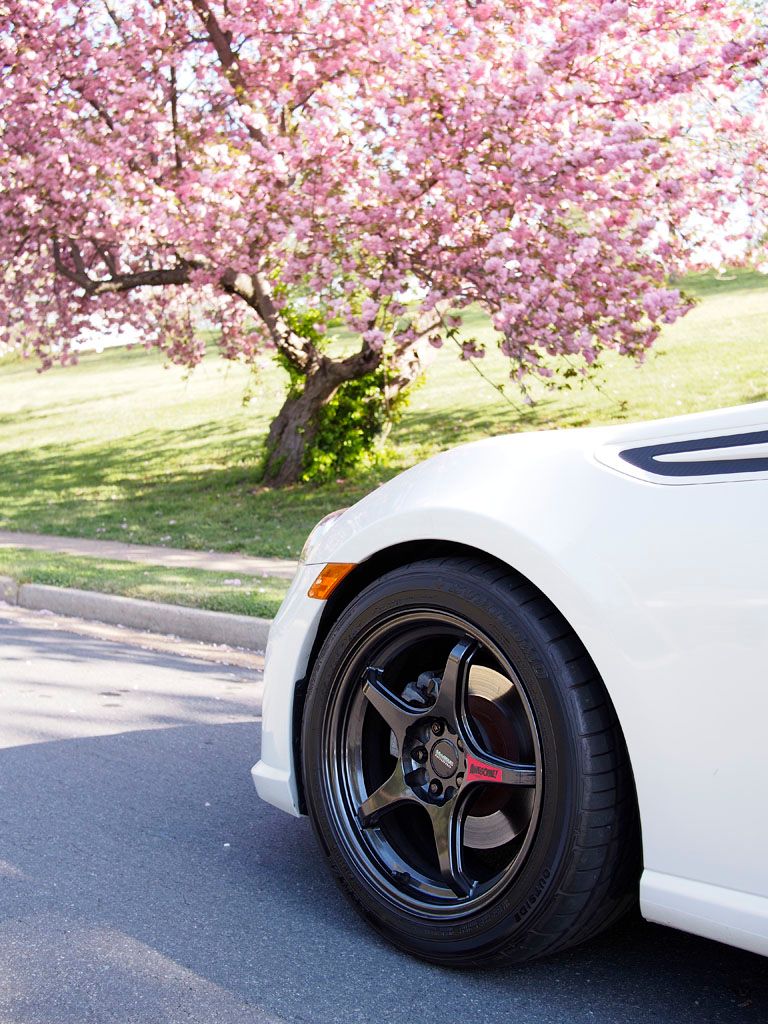

Mach V Dan 05-02-2013 01:14 PM
Originally Posted by shu5892001 (Post 879722)
35-40 you should be golden, not sure about 40+
+42 is perfect, in my opinion. We run 255/40R17 on our car, no spacers. It clears the suspension.
http://i6.photobucket.com/albums/y24...ps57af59eb.jpg
http://i6.photobucket.com/albums/y24.../6167small.jpg
Originally Posted by DAN_BRZ (Post 886439)
I don't know why ppl want to run a nice fat rim and then run a skinny tire.
They have to, because they selected too low of an offset, so their tires will run into the fender if they choose a tire that matches the wheel width.
To my way of thinking, if you can't run a wide enough tire to match your wheel width, you might as well choose a narrower wheel, and save some weight...
Originally Posted by DAN_BRZ (Post 906140)
...anyone know of any non aggressive 18x9.5 front setups?
As I detailed in this thread, our 18x9.5" Wicked Awesome will just clear the front suspension, although when we fit it with a 265/35R18 the tire rubbed the strut until we added a 3mm spacer. With a narrower tire, it might clear without a spacer.
--Dan
