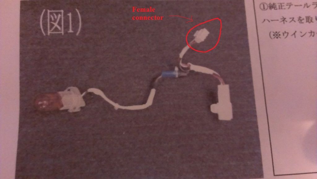

for those who want instructions here some pics from the instruction sheet:
like deedzman have said,you need to use the stock wiring and remove the amber bulb:
http://i1127.photobucket.com/albums/...ps8ec16afe.jpg

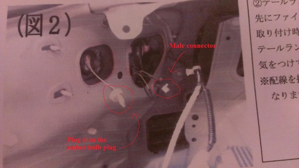

the plug on the news tailights are plug and play with the wire with the bulb...then you plug the male connector from the tailight to the female on the stock wiring
http://i1127.photobucket.com/albums/...ps839c90b1.jpg

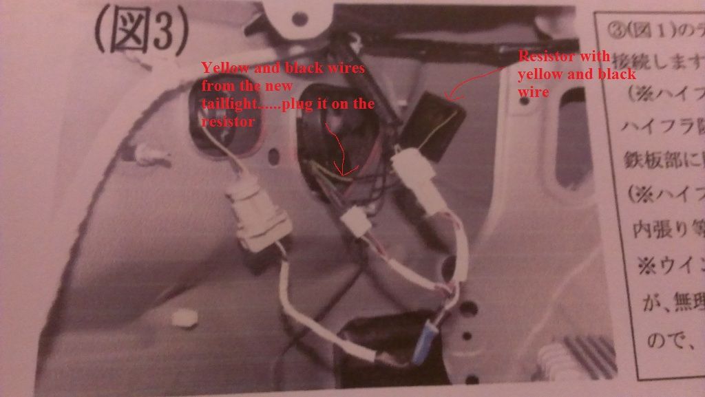

they come with 2 squares resistors(you can see one in the pic)
you have a yellow wire and a black on each tailight plug it on the resistor...and it's done:happy0180:
http://i1127.photobucket.com/albums/...ps26f0f55c.jpg
