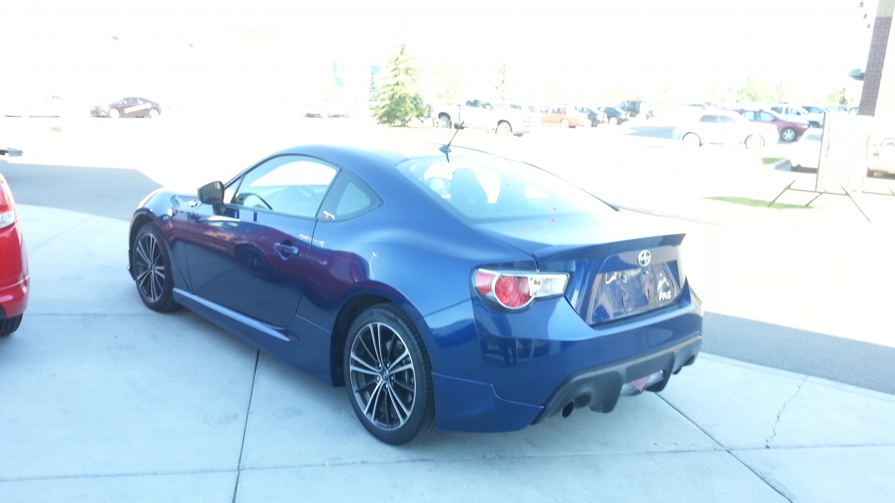

Really? That sounds odd. I live in Canada and when I went to look at the FR-S's, they only had one there and it didn't have the mud guards...does it have anything to do with the fact that it has the 5 axis kit on it?
Attachment 34424
Silverdub 04-18-2013 11:58 PM
Yes the kit wont fit with mud guards

kALMIGHTY 04-19-2013 04:36 AM
That's weird...I saw a few other threads where some of the members on here were looking for mudguards in GTA. I thought that was odd because I used to think mud guards were standard in Canada...
