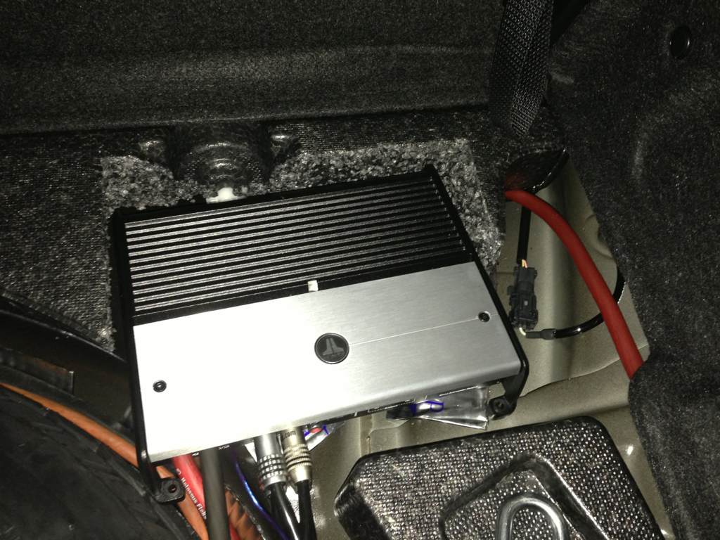

rbizzle004 06-08-2013 03:08 PM
Just installed my JL Audio XD500/3 in the trunk under the carpet like some of the previous people have talked about. It wasn't to hard cutting the foam pieces and getting the amp in there snug. I am going to get a couple of Velcro strips tho to make sure it stays in place.
rbizzle004 06-08-2013 03:12 PM
2 Attachment(s)
Attachment 40128Attachment 40129
AL008 06-09-2013 08:14 AM
I have the JL XD 400/4, pretty much same one as above.
On the AUS spec 86, the ones that don't have spare wheels, we have the foam and then a carpet mat and a rubber mat on top of it. Is it bad if both these are on top of the amp and thus providing no air flow to the amp?
