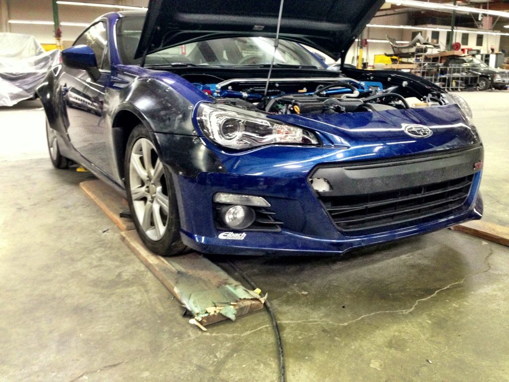

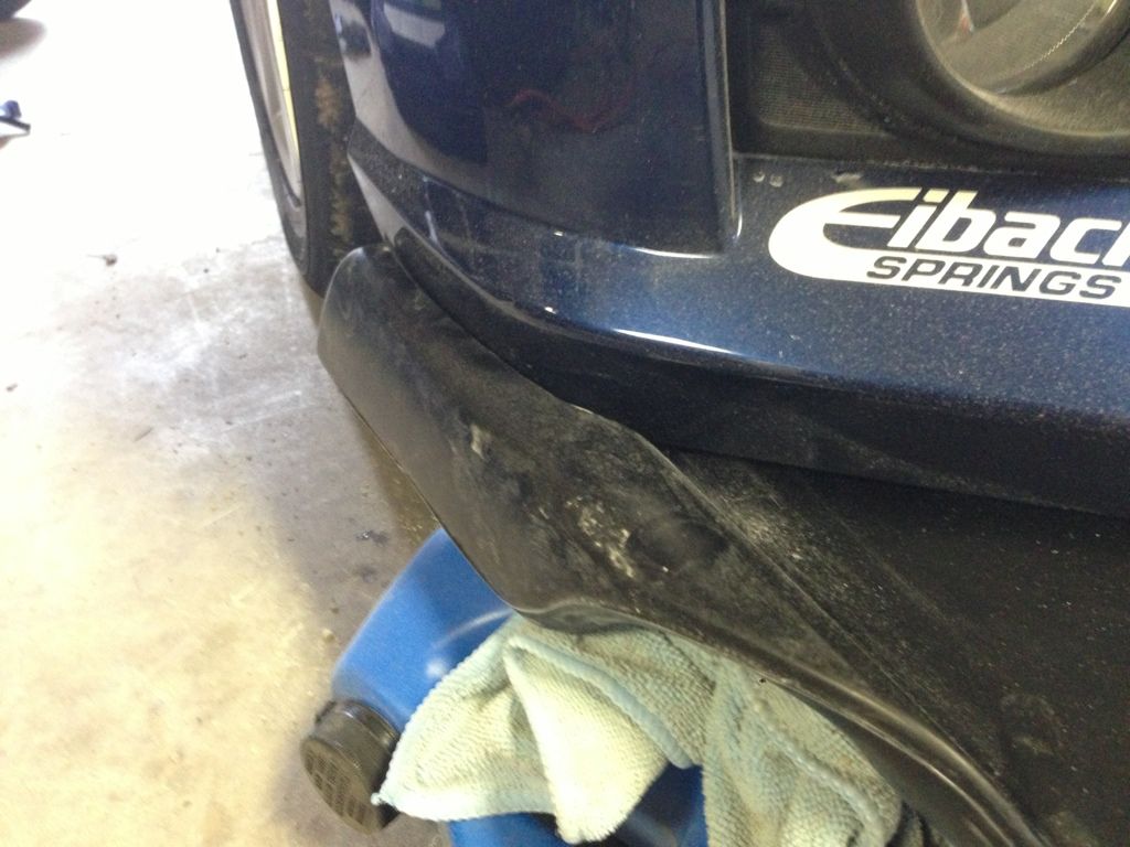

Trimmed out the lip. Did the right side near perfect, messed up the left though. Going to fill it and sand it down.
http://i1341.photobucket.com/albums/...psb580343e.jpg
http://i1341.photobucket.com/albums/...psdd9231eb.jpg
http://i1341.photobucket.com/albums/...ps877a4968.jpg
http://i1341.photobucket.com/albums/...psd3b1f72a.jpg
http://i1341.photobucket.com/albums/...psf7ff672c.jpg
http://i1341.photobucket.com/albums/...ps36962adb.jpg
VesperLynn 03-05-2013 05:17 PM
Also realize that it doesn't look too good at the moment because its only being held up by oil jugs. Lol

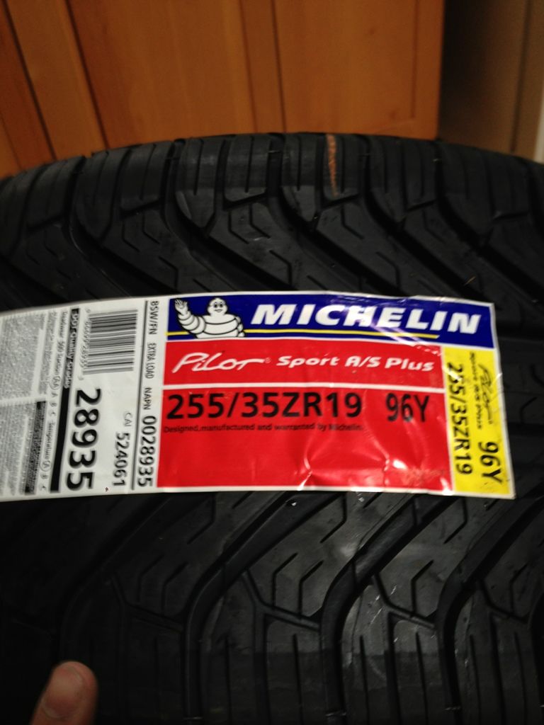

Here's the front tire I'm going to be using:
http://i1341.photobucket.com/albums/...ps24ce7542.jpg

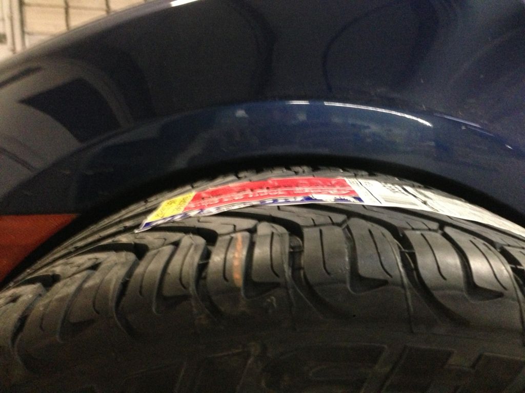

And here's the gap between the fender from stock:
http://i1341.photobucket.com/albums/...psd0e1c28e.jpg

An all season tire for your fronts? what will you use in the back?
VesperLynn 03-07-2013 11:07 AM
It's the same tire for the rear, just wider. I'll go to a t1 sport next but just trying out different tires for performance to see how each handles.
staycrushing 03-07-2013 05:11 PM
you are going to have issues with the rotating diameter in the front with a tire that big. be prepared to chop front bumper up, extension piece, inner part of fender cutaway and also grinding down the frame rail. i would step down to a 255/30/19 if you want to run that width. im running a 235/35/19 and still have issues with rotating diameter.

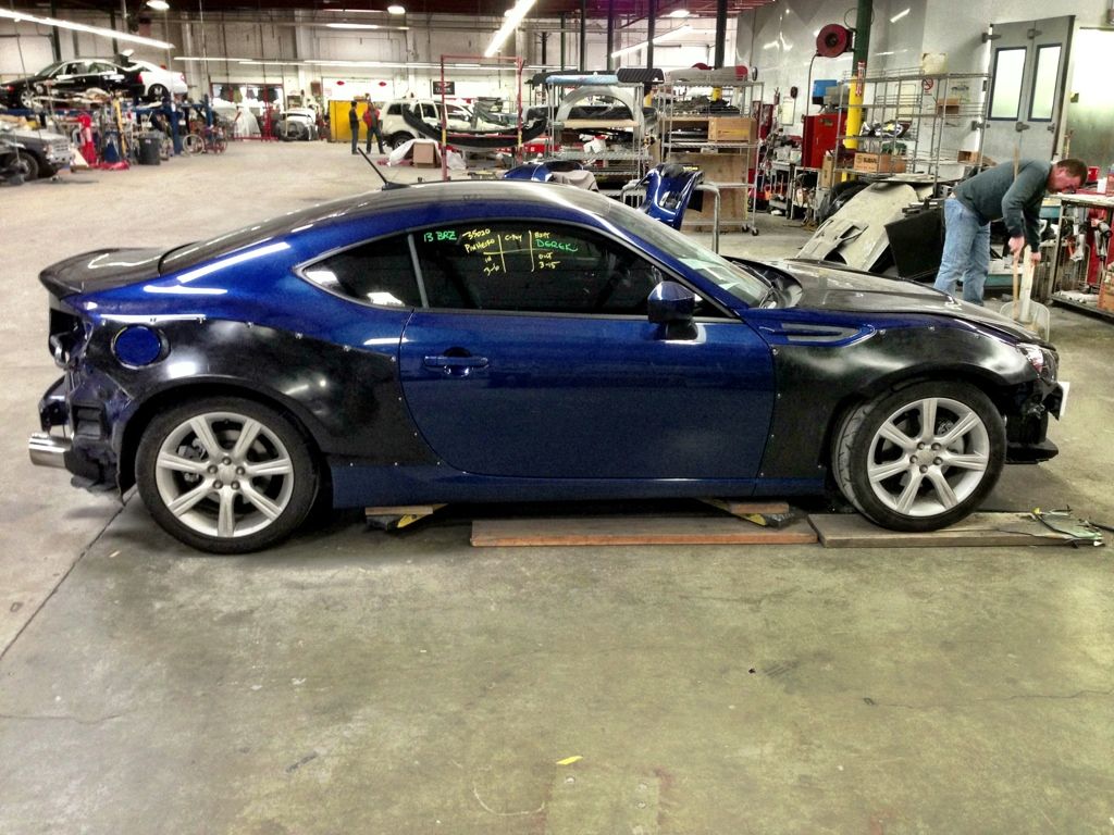

Anyways, They've started the body work. Checked in today and it's mostly just seeing how it's all going to fit on. They took the bumpers off and are measuring where to cut.
Also, as for personal preference, I've decided against using the front lip and side skirts. I don't like them. The lip is okay, but to me the side skirts look like a tacked on after thought. Going to go with either STI or seibon TA style skirts. Same with the lip. Either STI or TA style.
