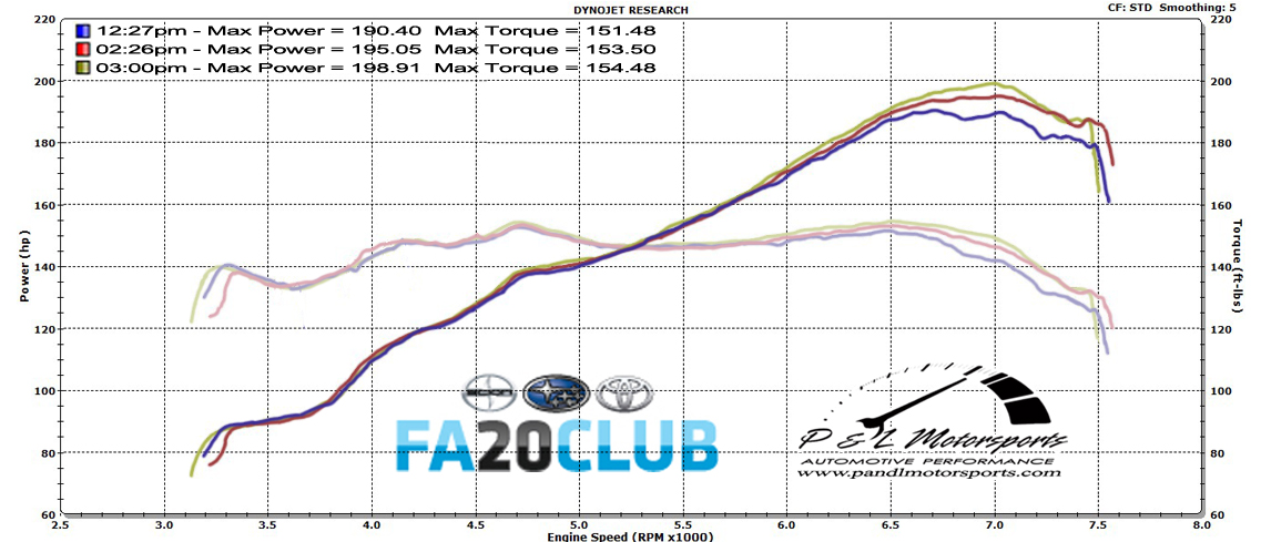

One interesting thing to note, is that the catted header is more linear and produces more torque in the 3300-3900 range. I wonder if it's due to the creation of a little more backpressure... but, I'm not an engineer, so I have no idea.
I did have Dylan whip up another graph for you guys just for schmidts n giggles, and I do believe in providing as much information and transparency as I can to the group.
https://s3.amazonaws.com/pandlmotors...a20-graphs.jpg
I had him combine 3 pulls, The FA20 e85 basemap, a run from mid tune, and our final pull. Tony did feel that there was more to be had from the tune, but also with this engine, there are a lot of things to play with. You can work on it all week and go nowhere, but suddenly with 1 small change you get a big jump, and another weeks worth of tweaking to do. We had about 30 dyno pulls, and 7 tune tweaks done over the timeframe that my schedule allowed.
Do I wish I could leave my car on a dyno for a week, and have a tuner devoted to perfecting my tune and posting a dyno of "the most powerful na, stock engine to date"? My ego says absolutely, but that wasn't the goal. With everyone having different setups, exhausts, intakes, as well as atmosphere, altitude, humidity, and even gas quality the goal was to make a solid basemap, and to show gains over stock. Something that P&L and @FA20Club.com did very well imho.
If you go with P&L, or Nameless I'm sure you will be happy with the added torque where the dip was.
