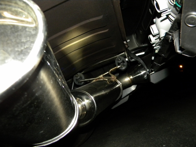

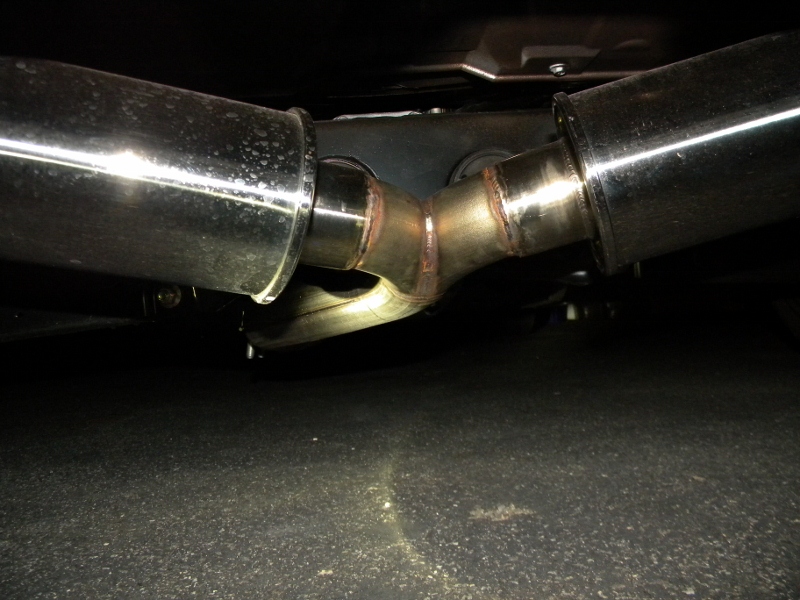

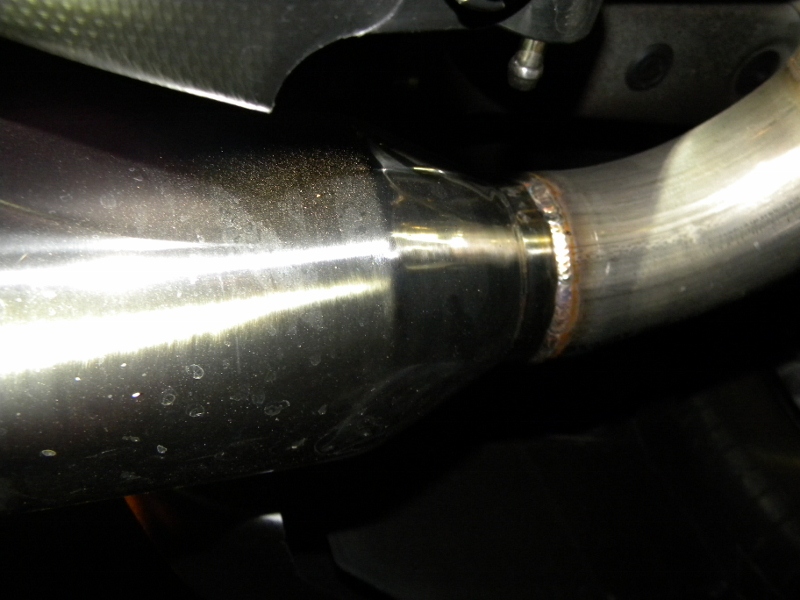

White64Goat 02-26-2013 09:51 PM
My SRT is all good. Saw the pipes in their shop when I went to pick mine up and they had stainless stamped right on them, tips too.
Attachment 29212
TRD_86 02-26-2013 10:07 PM
[QUOTE=White64Goat;759637]My SRT is all good. Saw the pipes in their shop when I went to pick mine up and they had stainless stamped right on them, tips too.
Man, your SRT really look good as what it supposed to call stainless steel. :)
fledonfoot 02-26-2013 10:42 PM
I've noticed this too.
My first Takeda exhaust rusted pretty bad after 3 weeks on the car. That one was sent back under warranty for a fitment issue (left side tip about 2" further out than the right side) and the replacement one started to develop the same surface rust after about a month.
I wouldn't mind so much if it wasn't for the one long outlet pipe that snakes around from the passenger side.
I plan on buying one of the "diffuser" knockoffs showing up now to help hide it for now. I plan on looking at the new nameless setup as a later replacement.
It's a shame, because I love the way it sounds.
White64Goat 02-26-2013 10:43 PM
4 Attachment(s)
There's a bunch of water spots on the cans in that picture. Here's a couple more:
Attachment 29215
Attachment 29216
Attachment 29217
Attachment 29218
