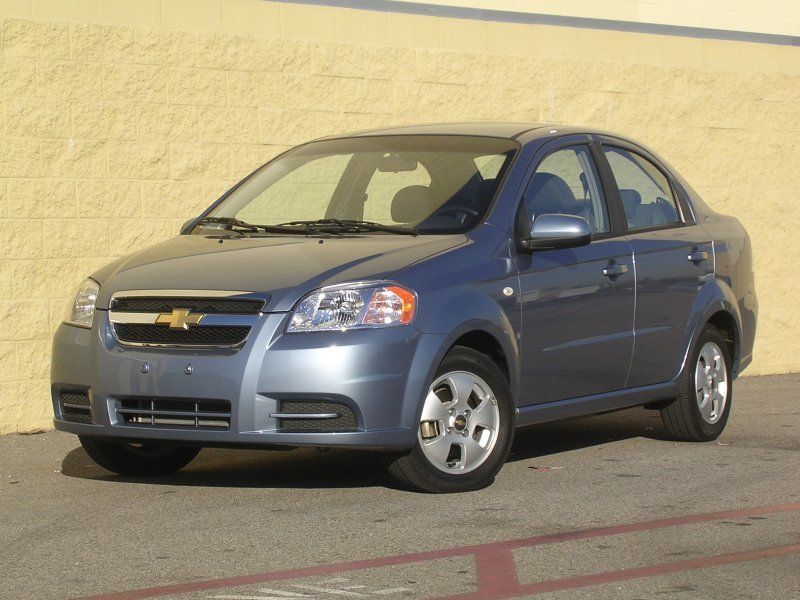

Count your blessings bro, I put my car in the shop to replace my cracked front bumper (after a suicidal dog) and I had to drive my GFs '07 chevy Aveo.
http://i177.photobucket.com/albums/w...psc70e2d14.jpg

Needs moar low.
(sorry, I had to)
