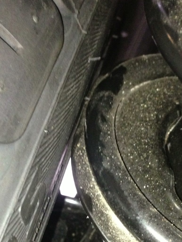

If you have the factory struts on the front the +45 is going to be REALLY close, especially if you add neg camber using bolts. I got a set of the +35s from LSD Motorsports and have RCE springs/Whiteline camber bolts. Test fit the wheels and I have less than 1/2 in clearance (http://www.ft86club.com/forums/showp...3&postcount=26) between the strut and the inside edge of the rim in the front. If you end up going with coilovers you'll have more room and the +45 probably would be fine as far as clearance with the strut is concerned.

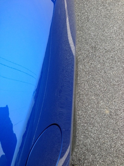

86•BRZ 02-14-2013 02:37 AM
This is with 235s on the +45s. Just fits. Yet to test drive. Just got 1 to test fit. What do we reckon. Will they be OK?
I reckon the +45s are the way to go with coilovers.
Attachment 28284

86•BRZ 02-15-2013 05:44 AM
so far they are running fine with no rubbing
the +45 poke plenty at std height

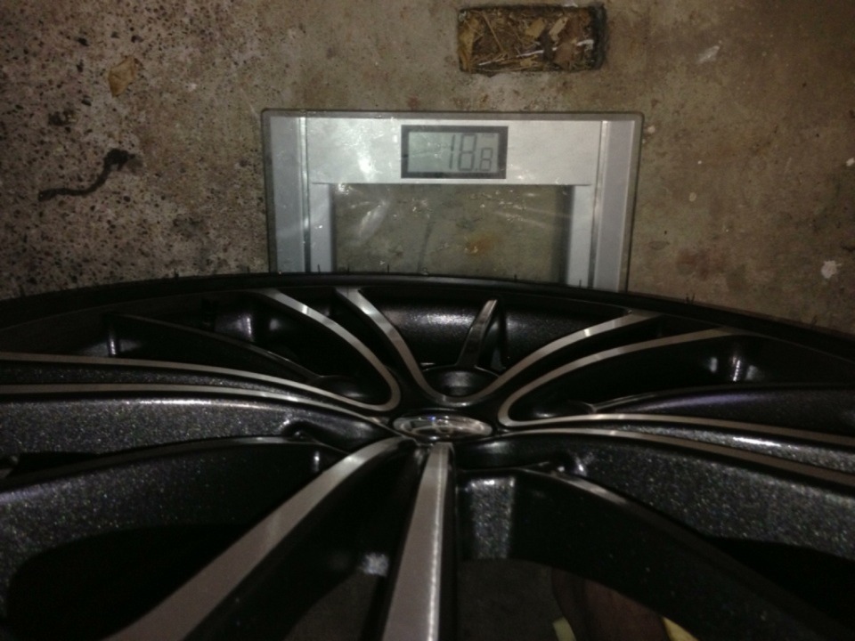

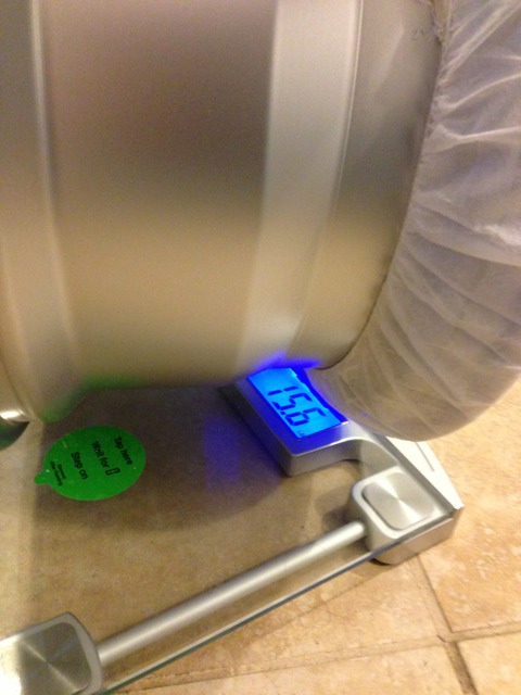

wgnzlz 02-20-2013 06:00 PM

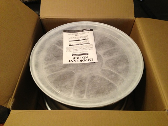

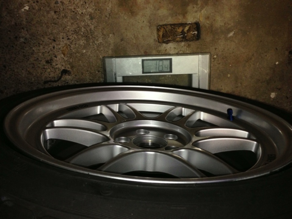

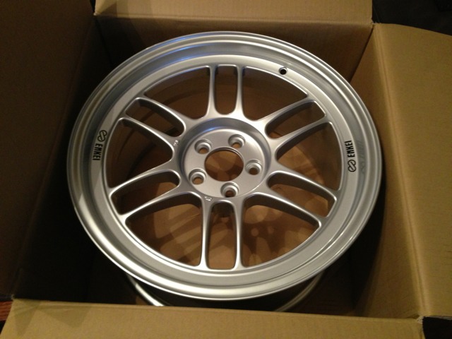

4 Attachment(s)
Just got my wheels (17x9+35)! 15.6lbs on my bathroom scale.
Attachment 28722
Attachment 28723
Attachment 28724
Attachment 28725

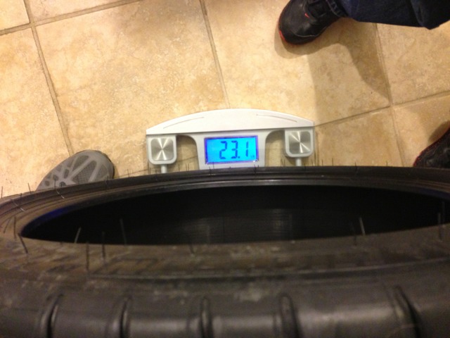

Got the tires today and will be getting them mounted tomorrow.
Pilot Super Sports 245/40/17
23.1lbs on bathroom scale
Attachment 28818
Attachment 28819
