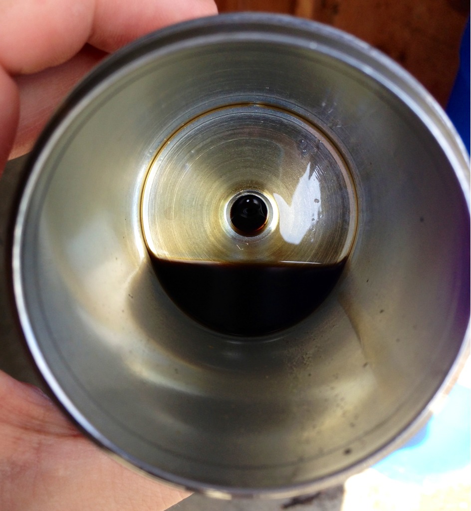

Since install, I caught this much oil.Attachment 36729
Not a lot, but its definitely doing it's job.

Sorry for nubness but what does this do for your car exactly (quantifiable gains)? I'm reading that it catches the oil before entering the intake so on a stock car oil just gets sent in? How often do you need to drain the oil? Does it help with engine longetivity?
Tim_Asphalt_FRS 05-11-2013 01:16 PM
All of the oil in the picture would have gone back into the engine and coated the valves, pistons and. It helps with cleanliness of the engine,longevity & performance. Probably emissions too.
